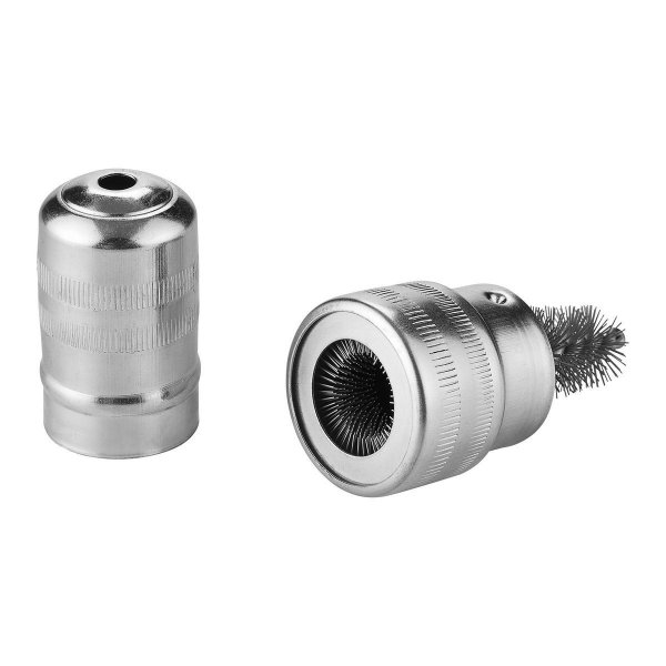

Public service announcement, clean terminals and posts are mandatory. since most shop at Harbor freight then buy one of these next time.
Battery Terminal Cleaner
