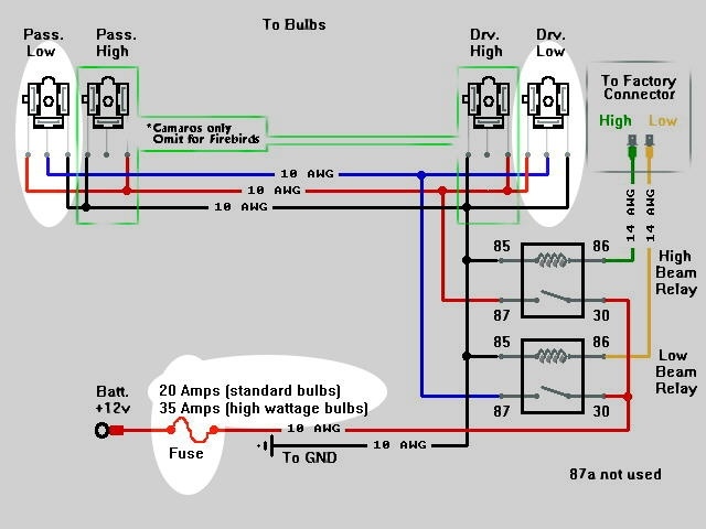

you can add on some relays that will really help them out.

Current draw is not that much more. If you have doubts about wire integrity you may want to add relays. I've added halogens to these old cars a few times now without the relays, no drama.

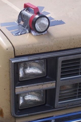

Regarding the picture above, you gotta appreciate that it was a factory option on some Chevy's straight from the dealership. At least they put a cloth under it to not scratch the paint!:rofl:
They don't give a **** about the paint!
That is for adjustment..LOL

I bought Halogen headlights from Summit that fit directly into the original bucket no problem. They now take the same bulbs as my 04 Dakota and have worked flawlessly for 10,000 miles now.. huge improvement! Relays are a must, I used 2 30 amp relays (1 for highs and 1 for lows) and wired mine where all 4 are on while on high. Very happy with them.
