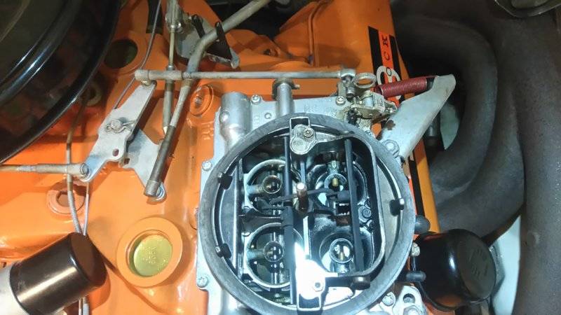

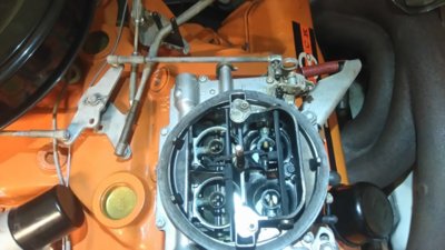

A picture of one of the carbs....
Do you run non-ethanol gas ? If it's been sitting with **** gas (aka ethanol) in the carbs for 6-8 months I'd be pulling the tops of the carbs off for a look.
It definetly sounds fuel related. Actually sounds like it's running out of gas. Were the fuel lines always routed, like what's in the first picture, of this post? The left carb fuel line and filter, look like they could get pretty hot, being that close to the exhaust manifold. Vapour lock???

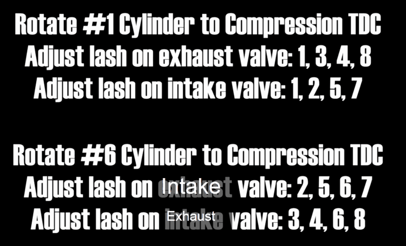

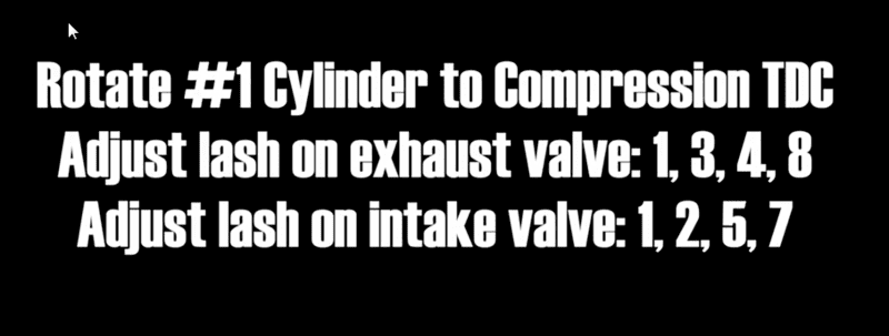

Sure on the solid lifters. Lash was set using the guide from Summit on youtube:
