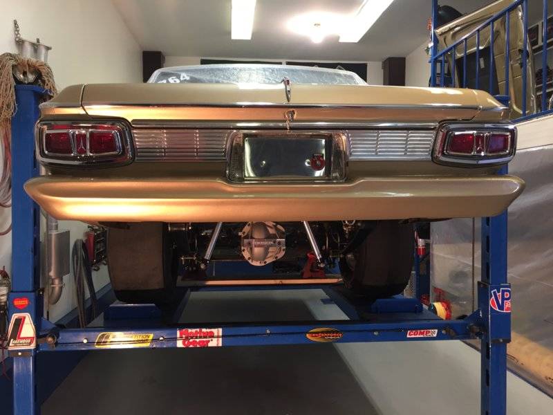

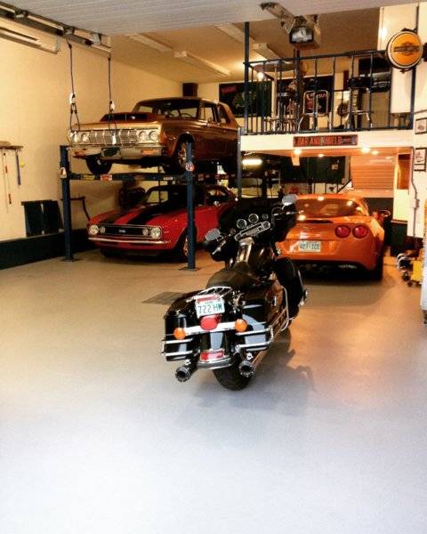

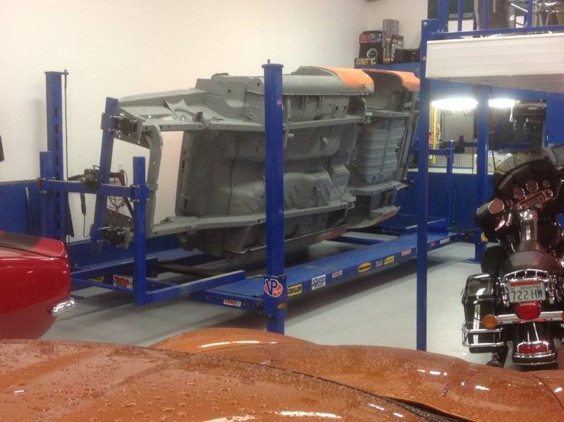

I built mine about 17 years ago. A 4-post and it's not secured to the floor. It ended up costing me about 2500 bucks to build it back then, can buy them for about that now.
My next door neighbor built his too, he has a 37 international truck with a built 350 and dual quads he lifts on his and it freestands with a frame, hes a retired air force engineer, maybe I'll get a quote from him
