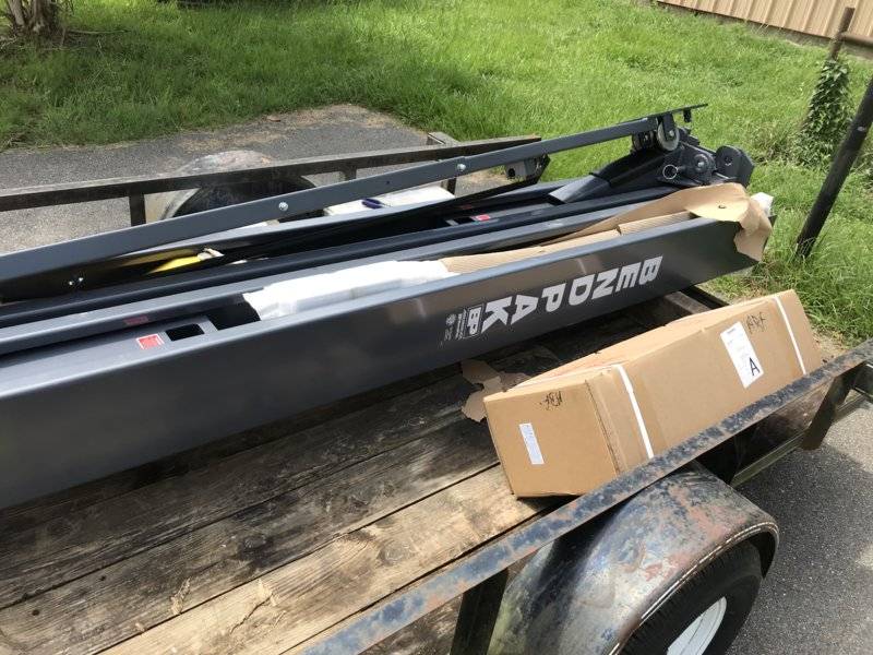

Well it’s here! Now will start the task of getting marked out and installed.
