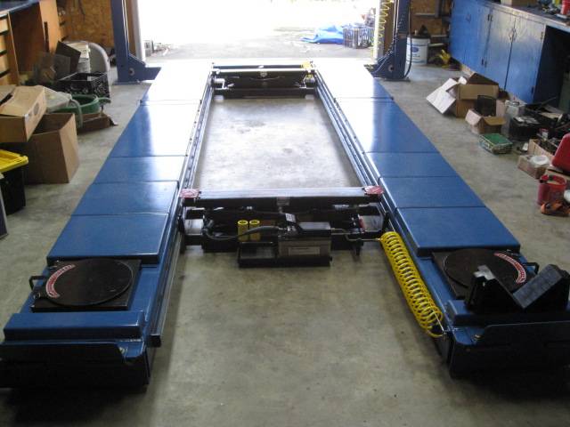

Hello forum, just finishing up a rebuild of a commercial alignment lift and find that I truly need an anti skid coating applied for driving on and off the lift safely if the environment outside the doors are a least bit damp/wet.
I am sure I am not the first person here to encounter said problem and hope to draw wisdom from those that have venture forth before me. I know many folks recommend sand and while a great aggregate, suspension in paint is an issue, sprinkling requires a real fast wet coat applied I would think first. As you can see in the pic...this lift is void of any means for traction. I got this used and have rebuilt it...thus the new paint, I saw no indication of a anti skid paint ever being there when I received this in a very used condition.

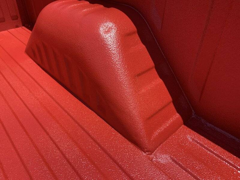

Why dont you spray a bedliner on it like T-Rex? Depending on pressure and distance you can achieve any texture.

my ramps as is the entire length of the runways are slicker than a baby's ***...smooth metal on the entire surface of the lift....thus the need for some cohesive substrate on the lift for the tires to gain traction...I knew I would eventually have to add a non skid of a sort but when prepping this lift I was more concerned at the time just getting it cleaned of rust dirt and debris, primed and painted as it was going to have to sit outside covered up till I got concrete pad poured so to move my other lift to and put this one in its place. Best product out there is this stuff....but I have not made inquiry...I know to be seated when I call...and yes most lifts have textured metal as in diamond plate...my other lift is as such...this lift....smooth, totally smooth

thanks....I thought of bed liner but what I saw of this stuff is it is often kinda slick...I will look into T-rex....for some reason that comes to mind on what my son had put nn his new Ram bed and gate....
I coated the underside of my car with it, and was able to achieve the different textures as I was learning to spray it. I think I got a 6 bottle kit with a schutz gun for <$200 & it is tintable.
I had Line-X in the bed of my 2500, it was about 1/8 thick and I never had things "slide" in it.

I agree with bed liner. I like Raptor liner. You can get the tint-able and get a pint of base coat in the color you want at your local paint supply store. Mix and spray.

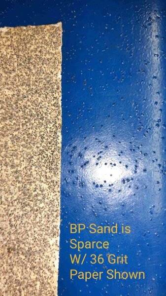

I just received a PM from a fellow BP lift owner that shows that factory finish lifts are 2 part epoxy paint with a light coat of sand mixed into the topcoat compared aside a piece of 36 grit sandpaper.....when he special ordered a lift some time back the factory sent a gallon of their epoxy paint along with the lift.....comparing to what it looked like when I bought one would never have known this....
this is the first lift I have used that was not at minimum made from diamond tread metal...I assure you with wet wheels on this lift...you going to have traction problems.
