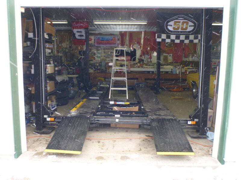

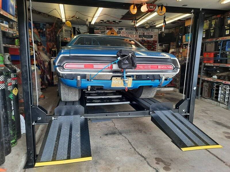

My ramps are diamond plate.. the lift is as smooth as a baby's butt !.. yet other cheaper 4 post lifts I've seen have diamond plate decks.
My other lift has diamond plate runways and have never had an issue off and on with it when wet outside and bringing a car into shop for work...wet day, first car on....issue right off the bat...figured it would be to some degree...but this is pure baloney and not what I want for performance...
Smooth lift runways are sure easier to wipe down and keep clean I will give them that....
What if you just drive on without stopping half way? Keep a little momentum going, obviously not wide open!

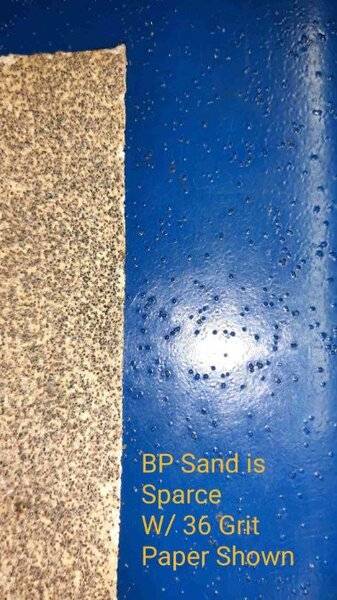

I just received a PM from a fellow BP lift owner that shows that factory finish lifts are 2 part epoxy paint with a light coat of sand mixed into the topcoat compared aside a piece of 36 grit sandpaper.....when he special ordered a lift some time back the factory sent a gallon of their epoxy paint along with the lift.....comparing to what it looked like when I bought one would never have known this....
View attachment 1066010 View attachment 1066012
I've seen something like this on military truck bumpers to aid in climbing on the truck......only it was closer to 16 grit

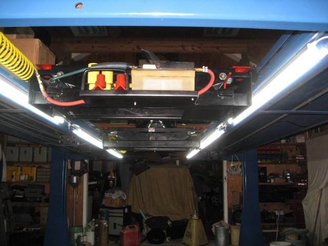

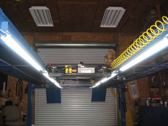

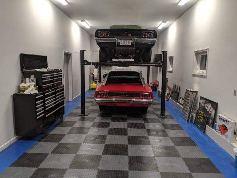

another small upgrade to the lift. As most folks know when storing a car on the lift and working another below or any project beneath for that matter, the overhead lighting suffers greatly. I decided to install these interconnected led tubes. They light up nicely as you can see, the overhead lights are off.
View attachment 1179409 View attachment 1179410
I see on you tube that they are putting those lights on the inside of garage doors that will help light up when door is open when the original lights are covered by the doors. Plugging them into garage door opener plug on a retractable extension cords. Not a bad idea I thought. The more light the better the older I'm getting.

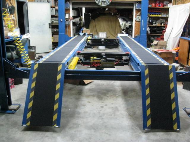

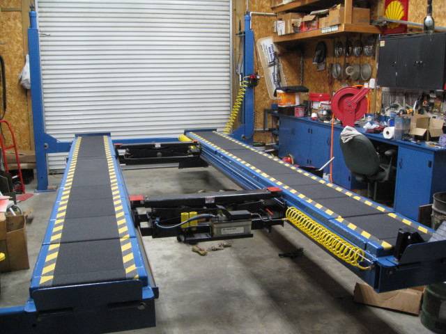

I like the light idea. I stuck on several rolls of 3" wide of anti slip tape on my hoist. It does help for sure. You can see them on the ramps.
a big yes on the lighted garage doors when up and blocking your normal lighting...good tip....
1. Peel and stick, after a healthy dose of brakleen to degrease all the surfaces. You get it in rolls.
2. Regular ol' paint, mixed with playground sand. Again, healthy dose of brakleen before application. Add a couple/few cups of sand to a gallon of paint, mix well, and roll it on. I'd suggest oil base, but in a pinch I'm sure you could use latex...not sure how long it would last, but hey - it's easy to reapply when needed!

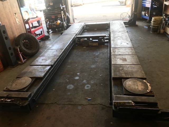

I have sand blasted and painted numerous alignment lifts. My buddy sells bed liner that is kind of clear, you mix in some paint and spray out of a texture style gun. It works very well. This stuff stays relatively soft for great traction
