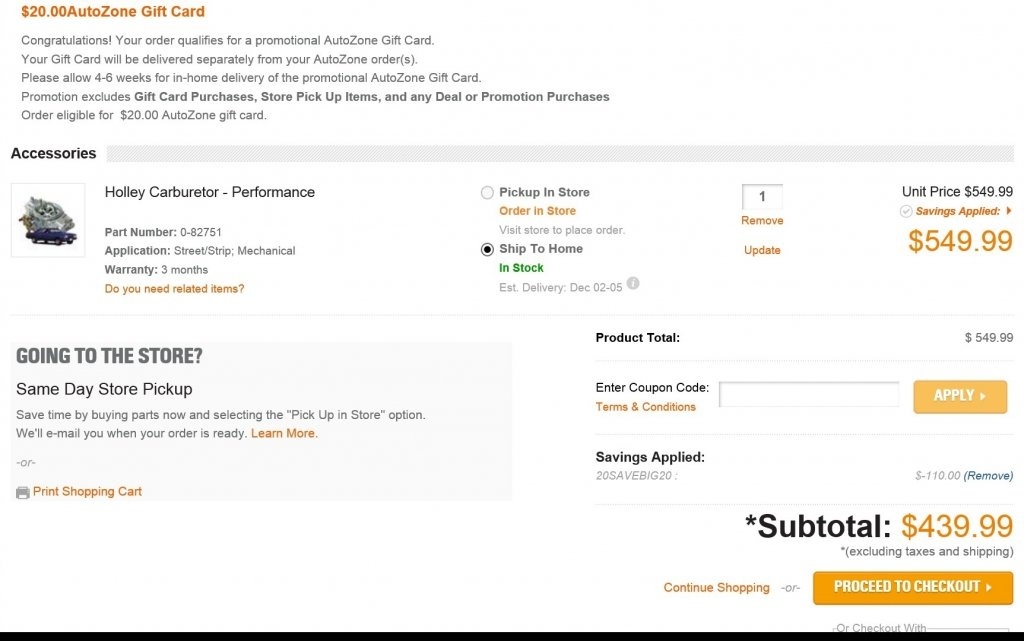

Here's a good one, on sale at Autozone with free shipping (ships from Holley)

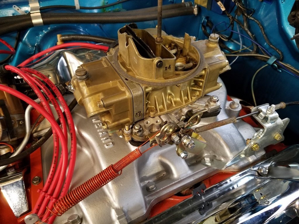

Here ya go, built this 383 many years ago and kept it for a special occasion. +30, old school 509, Weiand 8008. Ported 906 heads and original worked exh manifolds. I bought a new 800 AVS and spent the better part of the summer tuning, to no avail. Still ran like crap. All i did was move the issues to either low end, or mid range. Pulled an old 3310 off the shelf, rebuilt it, 5.5 PV, 50cc pump, and 78 jets, Voila !!. A word on Eddy's tho, street cars need the insulator, or you've got the problem you described.
