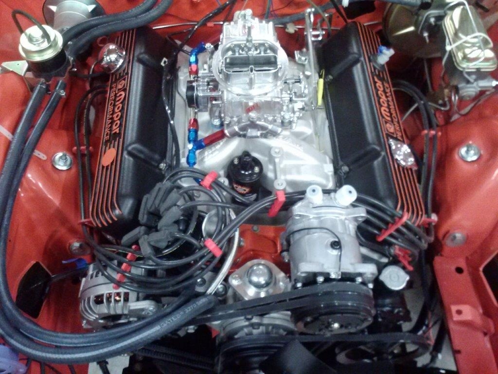

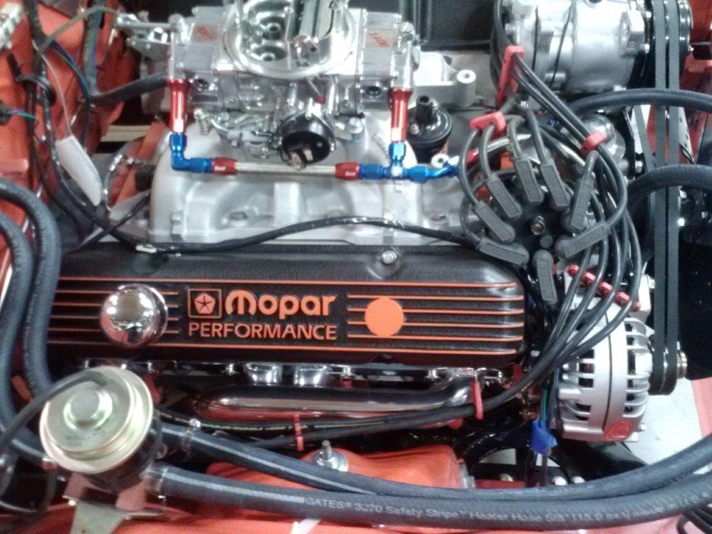

Rumblefish360 - the cam is not crazy, duration is 224/230@50 .. I built the motor a tad above stock, with the idea of a solid cruiser. I finished putting the holley 770 street avenger on the motor, what a huge difference! Feels like a totally different car. Very fun to drive now.
Excellent to hear this.
You had a problem with the (big) Edelbrock 800 on the (Mello) 383 because it was to big, IMO.
