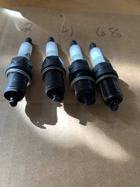

Swapped the plugs, looks pretty fouled. Guessing I should swap these out every 2k miles or so?

The plugs you show are 3/4" reach....you must have aluminum heads as stock iron heads 3/8" reach heads. My vote is to stay with the ORIGIONAL Carter AVS, jetted for your application. Did you mention if the distributor advance curve was improved?
