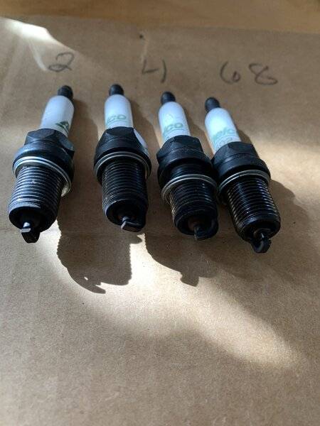

First time no start after about an hour of driving 10 miles. Started fine the next day. Swapped out the MSD Blaster 2, read somewhere the ecu doesn’t like it and put in a flame thrower.
2nd time, does at low speed. Started the next day. Replaced ECU with cheap one from summit.
thinking the plugs may be super fouled, I’ll swap them today and report back. Thanks for the help.
may just deal with the cam for now until I’m ready to pull and rebuild bottom end.
thanks for the help
Swapped the plugs, looks pretty fouled. Guessing I should swap these out every 2k miles or so?
