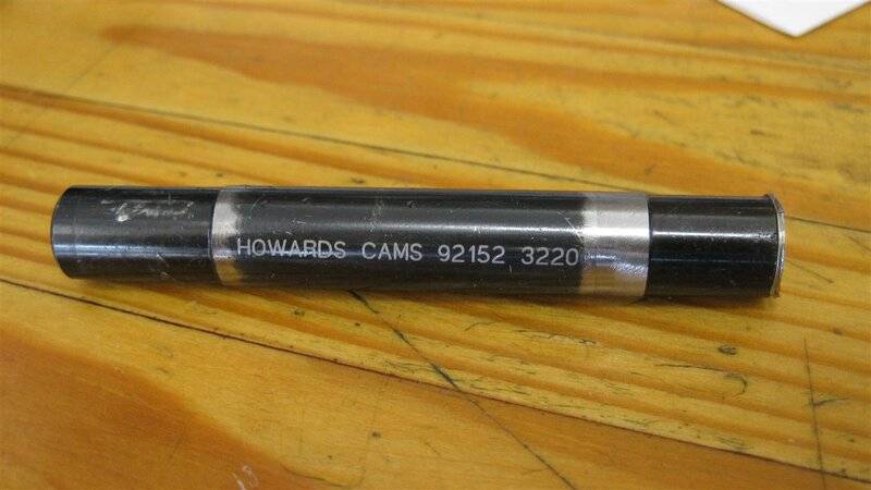

Hello to the B Bodies.Changed fuel pump and filter on a 383 ,hardly runs step on it it dies ,fuel to the carb, no fuel enter carb maybe needle seat and float troubles.

Pull the pump and the push rod and check the length of it. If it's an aftermarket one they are known to wear quickly and be a problem. Should be about 3.23 in length.
