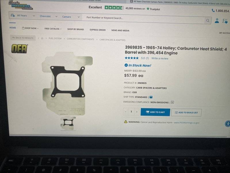

At the speed shop I used to work at back in the 80's, we sold quite a few of these shields. They were oe GM at the time. Works for any standard flange carb like Holley's, Carters etc. They used to make another version that was for spread bore carbs, q-jet/tq's etc. These units are very effective for dissipating heat and are thin. One gasket, the shield, then one more gasket. You may need to trim in areas to get around stuff since you're crossbreeding. They were especially effective on RV's.

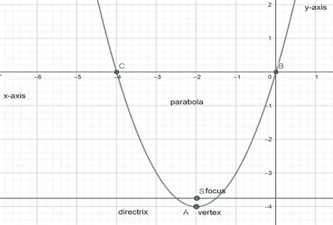

this is a parabolic curve.
I'll look into this. Thanks

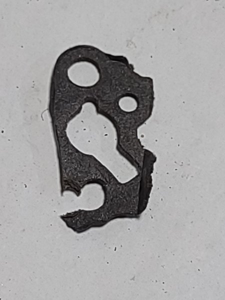

I solved an annoying fuel leakage issue on my 1967 4327S AFB. When the engine was warm, fuel would drip from the area near the primary shaft on the driver's side of the carburetor onto the intake manifold. Noticed only on these hot days (over 85F), even with the engine off, the dripping, a drop every 5 seconds or so, would last for at least 20 minutes until things began to cool off (fanning the carb would speed up the stopping of the drip). I was thinking there was still some suction out of the bowl occurring even with the engine off.
So yesterday I disassembled the carb again and checked the gasket under the driver's side venturi, and it was ripped by the screw hole, or more likely, the screw made its own hole. This had to have occurred during installation during a recent rebuild. I replaced the gasket, operated the engine until warm (it was really warm here yesterday in the NY metro suburbs), and no more dripping. I saw this suggestion in a 2022 thread here, so I gave it a look... sure enough. Thanks to all on that thread!
