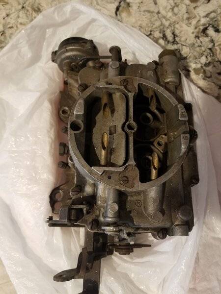

Greetings, my Mopar owners……my Carter AVS Four Barrel carburetor is pretty much at the end of its life span…..I’m not saying that it can’t be repaired but it would require a lot of work…Now my casting date reads D9 4615SA….April 1969……now can I get by with a carburetor that may have for example A9, C9 etc….that would be accepted as one that may have gone on my car…..I have a numbers matching 383HP four speed car….just inquiring as if I need to find one exactly as mine or could possibly have a slight variation in numbers and or letters….I’ve looked at numerous carbs that came close but alway off a letter or number….I’d appreciate knowledge responses from you…..I’m really to the point that I’m going to put on a Edelbrock AVS 650 manual choke carb and stick mine in a box…..it’s really to the point that It’s not run right for decades and quite honestly I’m surprised it even starts….

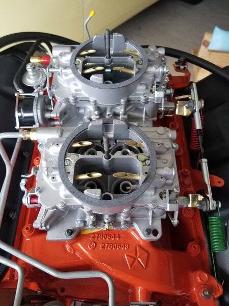

Another plug for Dave and his team at Woodruff Carbs. Here is a before and after.
