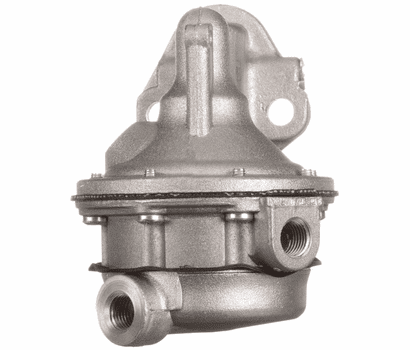

I had a fuel pump go out and didn't have a spare on the shelf. Every big block car I own uses the same pump, unless it's a Hemi. I ordered a couple of Carter pumps from Rock Auto, just using their fitment on the website. I thought nothing about it, because when they arrived they looked the part. It was a usual install until I got to the pump outlet. The metal line that hooks there wasn't even close. It turns out that the outlet is metric and not even close. No one makes an adapter for this that takes a metric fitting and goes to standard 1/2"-20. I then went to a local parts house and they tried to sell me the same damn pump. I told the guy at the counter that there wasn't anything metric on a 440, 383, or any vintage Mopar. Just want to let everyone know not to make that mistake.

You would need a brass adapter with that thread size on the pump end and 5/16 female inverted flare on the other for the flared line end. the 5/16 inverted thread is 1/2 20 tpi
Its stupid the way they change things. The 1/8" - 27 NPSF is basically a 1/8 npt. The f suffix is for fuel and there is a minute pitch change supposedly so the fittings seal without sealant. I use a film of paste and a 1/8 npt will go in there.

Always wondered about the "hemi" fuel pumps:
These things have 1/4" in and out, yet they're rated 120gph.
How the heck is that possible?

Jerry, I'm wondering if the M4434 isn't the one you're after? Supposed to have a 1/2"
outlet?
outlet?
I agree Ed. Looking at those Carter pumps with the 3/8 inlet and that little bitty outlet made me think the same thing.

Yes, it may work, but may still need some kind of adapter for the flared line connection. If the pump I'm looking at doesn't work, I will get some of those adapters as in @pnora post.
