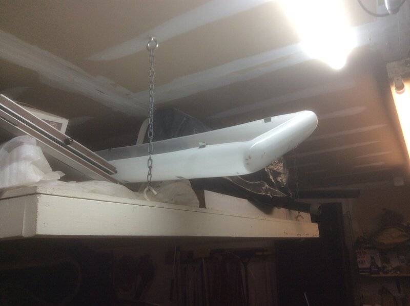

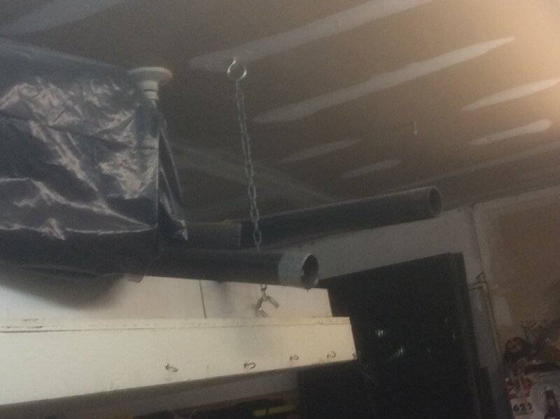

I just hung 4x8 sheets of 1/2" plywood with 2x4's. Attach to ceiling joists. They are dropped about 20" from ceiling. One sheet of plywood above each garage door. They hold alot of stuff, for sure.
Hung 4x8 plywood with 2x4's around perimeter. Screwed 4 eye bolts in the CENTER of joists and perimeter of plywood. I wasn't storing more than 300 lbs so I used S hooks and swing chain. Been up there 20 years.

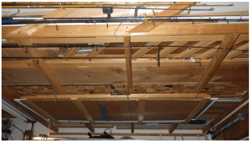

For above my garage door I did 2X3's, 1X2's, with all screws. Lol, It don't take long to fill it with "stuff"!

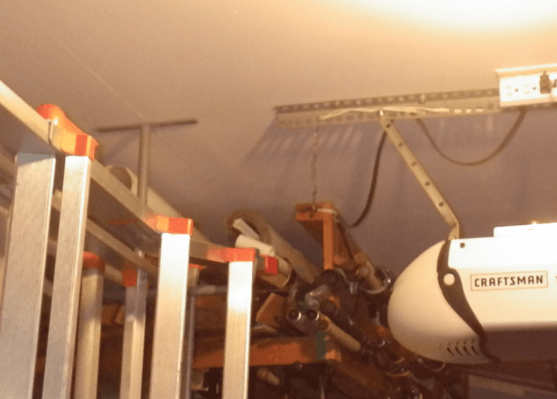

I have hinged storage for a full view storm/screen door along with a 4" light hanging underneath.....
The two ladders are hung with store bought hangers. If you are 6'2" ya' have ta' watch you noggin!....

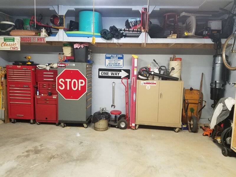

I've done homemade shelving on teh header panel above the door and liked it. Obviously cannot access any of that if the door is up.
Similar shelving along the walls, mounted to the studs and with periodic braces up to teh joists.
If concerned about that weight/structure, some posts down to the floor can help as well.
I have also done a 4x8 plywood shelf that the car noses underneath.

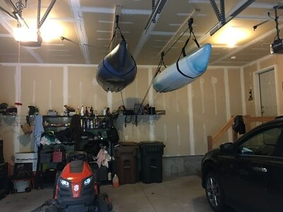

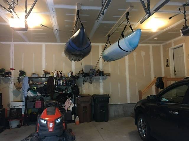

I hang my kayaks with a pulley system. Works great. Can be used for other things like bicycles etc too.
