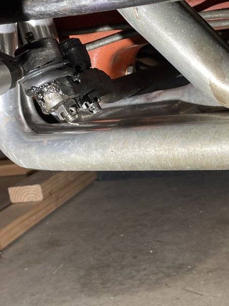

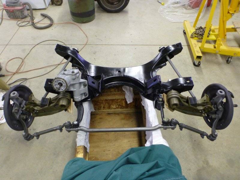

So after a complete front end rebuild the center link is rubbing very slightly on the headers (problem 1).
When I rebuilt my LCA I welded in the stiffing plates and one side was off just a small amount that the torsion bar adjusting bolt wont go all the way through the given hole in the plate without the bolt head hitting the edge (problem 2). So the height adjustment is very low currently.

Hard to tell by your pictures but I believe you have the center link on backwards.
Ah I was trying to determine why I have a problem now after the FE rebuild. The idler arm is new but that’s only one side. I’ll try to get another picture of the center link. It was difficult to determine which way the center link goes (for me anyway).
Agree and good eye. Flip it over and it should hit the header where it used to.
As above, the link needs to be flipped around.You can see the dent In the header where the centerlink hit when it was the right way around. It can't be installed upside down.
Thanks guy I'll see if my neck I can reverse the center link and will report back.
shouldn’t?
You mean shouldn’t be installed upside down right because mine IS…. Just not correct.
