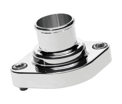

Thermostat housing can be a pia. Mancini Billet solved mine.
I just came back from the "billet water neck" rabbit hole. There are so many! I'm liking the O ring variety. Any comments?
https://www.manciniracing.com/bispalwane.html
I had this one from Mancini (not the O ring) and after two years it had warped .030.
https://www.manciniracing.com/mopv8throug1.html
My thread, and I went back to the factory housing...
https://www.forbbodiesonly.com/moparforum/threads/thermostat-housings.176744/page-2
