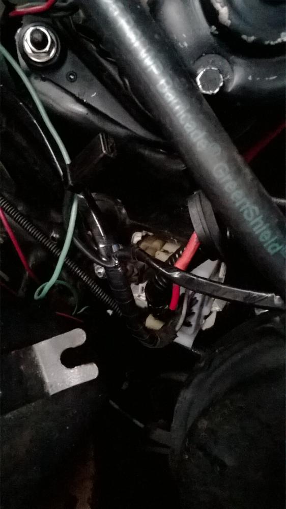

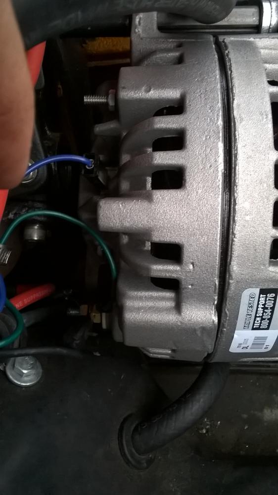

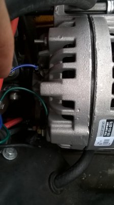

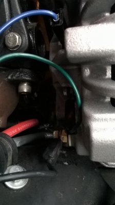

Checked the alternator wiring and not sure what I have frankly. I'm attaching some pics for anyone to look at. The blue and green wires go up to my voltage regulator and the black wire which is also on the back rear of the alternator- what I thought at first was the ground - goes over to the back of the fuse panel (pic 3). There is no other wires off the alternator, no ground wire that I can tell.
So I took the black wire off to attach another wire for a ground and when I did, it sparked and blew a fuse - so obviously there's power to it and it's not the ground. Not sure what exactly this black wire is. I then reattached the black wire, put a new fuse in and the car was back to the way it was in the beginning.
I tried attaching another wire from a different screw on the alternator to the chassis for a ground but it didn't seem to make any difference in the whole charging system/battery issue. Sooooo, where should I go from here? Do I need to run the ground to the battery rather than the chassis? WP_20160123_15_20_11_Pro.jpgWP_20160123_15_20_01_Pro.jpgWP_20160123_15_20_49_Pro.jpg

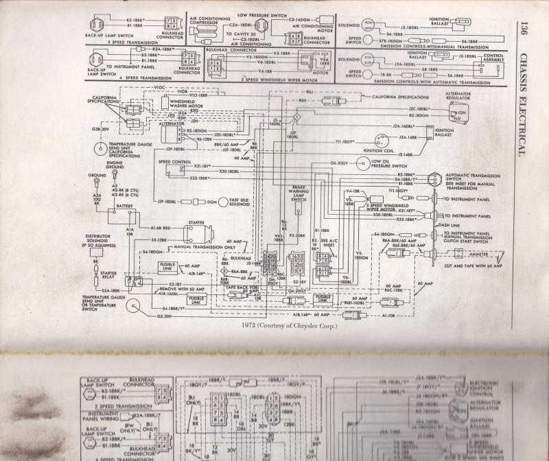

Hey beep, the large black wire (12awg I think) is the main power source from the alternator to your system when running. There is no ground wire connection directly to the alternator as the DC- or ground is bonded through the alternator bracket/engine which should have a large wire connected to the battery neg post. This is vital and all of the connection points should be clean of paint and rust. Here's a schematic from a '72 which is similar except the emissions and ignition stuff.
The green and black going to your regulator are shown here.
Here's a simpler diagram which might help. It's important to make sure the regulator has a good clean ground connection to the firewall also. The bonding strap or wire from the engine to the firewall helps to ensure this.
Here's another.
