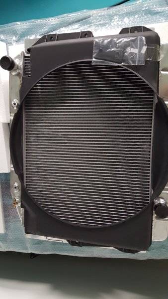

Speed Cooling ie ECP. Not a bad unit with 2 big 1" rows. However, l hope your 26" unit doesn't have a fan shroud like the one pictured in the link. Where's the other 3" of shroud on each side? We also had a customer drive up to our booth at Good Guys show and the side braces ended about 1" before the end of the tank on both sides. That's 8 missing tubes. For just a little bit more, you can get Griffin and Be Cool quality from Our dual 1 1/4" units. Our shrouds cover the entire core. Our cores go to the very edge of the tanks. There's more. Check out coldcaseradiators.com if you are interested.

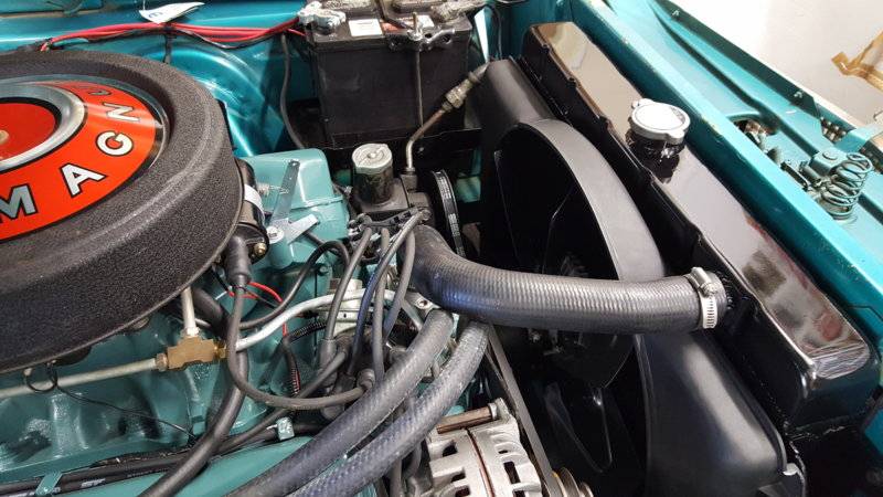

Yes, that shroud in the picture is stupid. I run a factory replacement shroud and it fit just as it should ...
I have run 3-4 champions in the last 10-15 years and never an issue fitting, even a factory shroud bolted right up. I’m pretty sure the 70 B/E Body shroud for the 26” Radiator is the one that fits perfect. Assuming you buy the 26” Rad.
