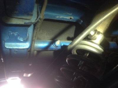

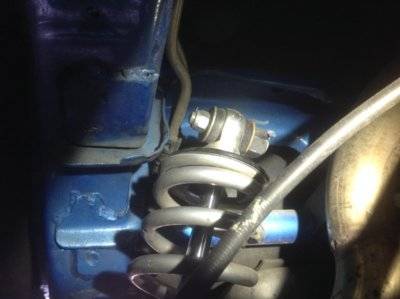

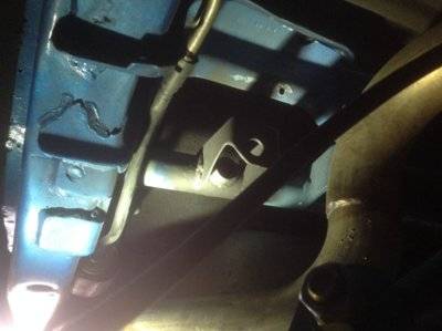

Bio...IF you go with the StreetLinx rear suspension, Throw away the upper shock mount "bolt/pin" and go buy a "HARDENED" one to replace it. I ended up custom fabbing one from a grade 8 bolt of correct size. The bolts that came with BROKE OFF after only 15k miles. Here is a post about it.
https://www.forbbodiesonly.com/moparforum/threads/4-link-shock-mount-failure.180457/#post-911376596
I saw that. Thanks for making sure I knew about it!

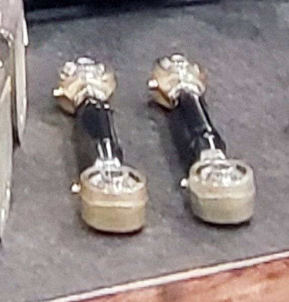

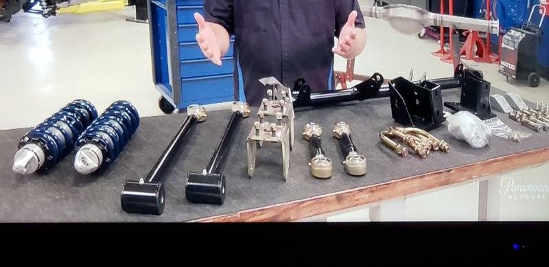

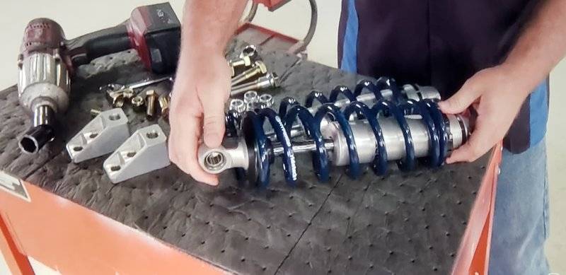

I kept the episode of Detroit Muscle where the installed the RMS StreetLynx and Ride Tech coilovers.
I'm trying to get a comparison between your pix and pix from the show.

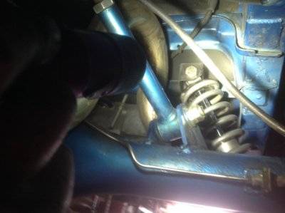

Here are a few of your pix from the thread you linked:

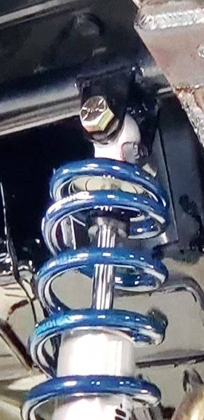

And here are some pix from the Detroit Muscle episode:
Is the upper coilover mount the same in the show as yours?
Also, I like the fittings on the ends of the upper and lower control arms that are from RMS.

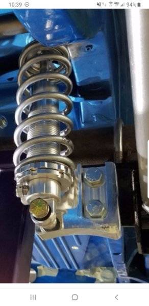

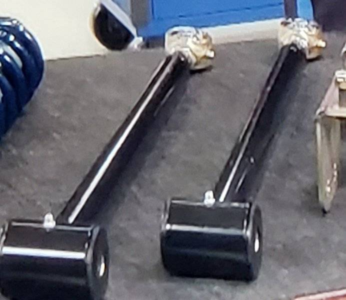

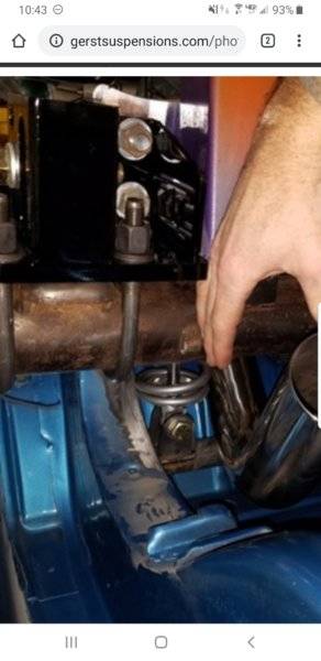

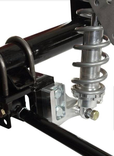

Here's a few pix of the Gerst triangulated rear suspension system:
The joints on the ends of the Gerst links look like almost all of them are just bushings instead of the much nicer looking ends on the RMS. The lower coilover aluminum mount bracket of the Gerst is also quite a bit different, being a reinforced L, but I'm not sure if I don't prefer what "looks stronger" since there's no L to break on the RMS.

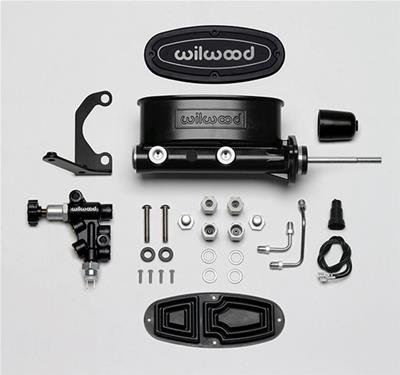

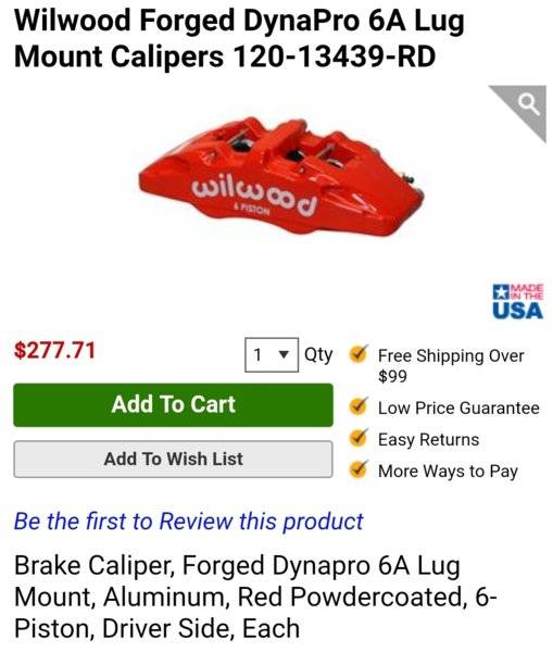

I paid for the Wilwood disc brake system today...
I also got the part numbers for the exact master cylinder and the SIX piston caliper that they swap the 4 piston caliper out on the rear brakes so I can have "bragging rights" in having the unique layout of SIX piston calipers all around!
:bananadance:
Rear calipers:
Master cylinder and proportioning valve:
From the pic you posted...That is NOT like mine! On mine, the weight is entirely supported on the bolt as it connects perpendicular to the cross bar. In the pic you posted, both systems actually, the mount is directly UNDER the cross bar so the weight is borne primarily by the cross bar rather than the bolt. A MUCH better engineered design.
So if I read correctly, your rear suspension system is a RMS StreetLynx w/ride tech coilovers? I guess that RMS changed the design?
