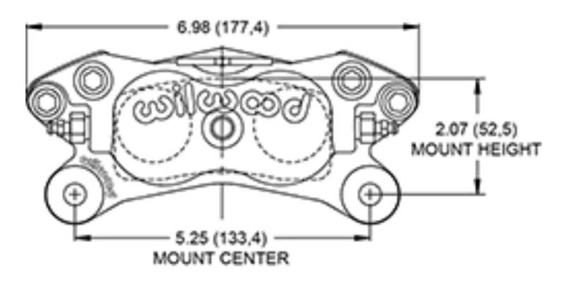

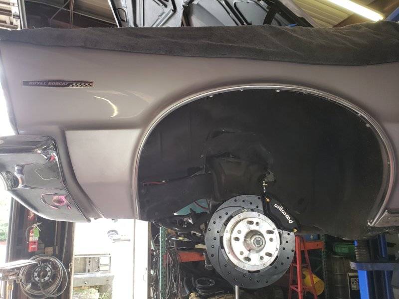

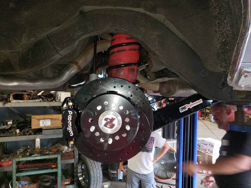

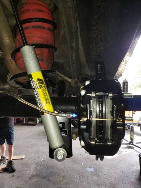

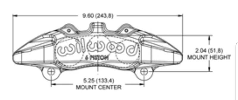

I think somewhere he mentioned a prop valve for the rear brakes. That should dispel any safety concerns.I would not let anyone Frankenstein a brake kit together for me. If wilwood Does not offer that rotor/caliper combo DO NOT PUT IT ON YOUR CAR!!! That is a very dangerous situation and could be fatal In the event of a failure! Think about it do you want to sacrifice safety for looks? Just get the 4 piston calipers that come with that rotor or if you really want the 6 piston fork up the money to get the correct set up.
Guys, I really appreciate the comments and concern, but Quick Performance has done the 4 to 6 piston swap on the 12.19" rotor quite a few times. The 6 piston caliper is available separately from Wilwood, and the way it mounts uses all factory Wilwood hardware. They are just making the swap. The QP rep explained it to me, and I probably have my picture and contact info on the cubicle of every rep at QP from the HOURS of phone calls and emails I've been involved in with them, reviewing the most minute of details, in particular on the rear axle assembly for the GTO.I would not let anyone Frankenstein a brake kit together for me. If wilwood Does not offer that rotor/caliper combo DO NOT PUT IT ON YOUR CAR!!! That is a very dangerous situation and could be fatal In the event of a failure! Think about it do you want to sacrifice safety for looks? Just get the 4 piston calipers that come with that rotor or if you really want the 6 piston fork up the money to get the correct set up.

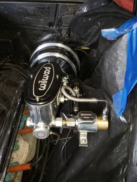

Yes, it comes with a very nice prop valve. There is much more to it than just adjusting force in making this work, and I can assure you that this is a "fits like a glove" swap, and uses the Wilwood hardware. No smoke and mirrors, just a happy coincidence.I think somewhere he mentioned a prop valve for the rear brakes. That should dispel any safety concerns.
I just sent an email to the rep at Quick Performance requesting a detailed explanation. I'll follow up with a cut and paste.I would just hate to see something happen to you and or the car. Safety first! If you are confident in it go for it i I know you’ll do your due diligence! My thought is just if wilwood doesn’t offer the 2 together there’s got to be at reason.
Roger that.He has no kids, that explains it.![]()
and.

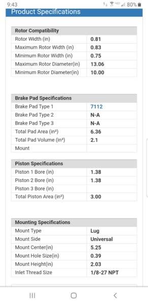

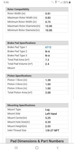

Looks and "bragging rights"Piston area is 3.00 vs 3.08. So, it's just an upgrade from 4 piston to 6 for looks.
When it comes to braking, one can only brag about the stopping distance.and.
