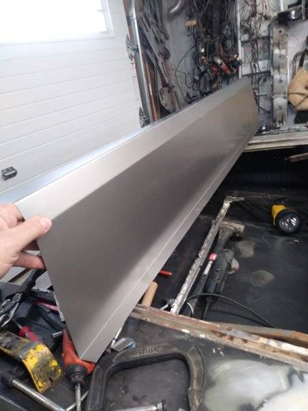

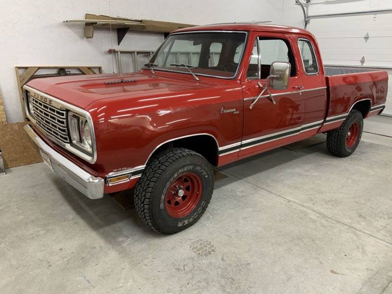

I cant afford to have my modified bumpers re-chromed as the welding work would need to be touched up to get it all leveled out. I will be using either a wrap or the paint for both bumpers..
Will I was watching the fabricator at the local steel supply bend this up for me..
I noticed some sheets of copper next to the wall. I asked about them and he said they are not really a steel supply but rather a supplier for metal roofing companies making gutters and returns etc..hence the copper. He showed me a window planter box he made last week, out of copper. It was clear coated so It wouldn't go green. Now I'm dreaming of places to use copper on the Express....
