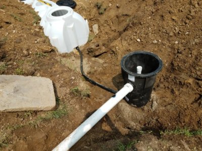

I'm pretty sure I've got this covered but like hearing different ideas so here it goes....
We built our house 15 years ago and have relied on a preexisting spring for all of our water needs ever since. As the family grew we went to a front load washer and offset the demand but now we added another and am sick of all the silt (shallow spring) so we're starting over. The old one is a 575 gallon above ground concrete tank whereas the new one will be a 1150 gallon burried plastic tank with a submersible pump on a 40/60 switch. I hit 3 springs digging our basement and fortunately took the time to develop them so there's lots of great water dumping over the hill plus 2 more springs to tie into... long story short I live on an oasis.
Questions are what's a good method of pre cleaning the water? If I only use the springs from the basement which are deep and filter through gravel I'm not concerned but can't see wasting the others. My thought was to burry a plastic 55 gallon drum ahead of the tank, plumb a pipe from the bottom of the drum to just shy of the top to feed the cistern with the overflowing water then the incoming water from the springs would feed in halfway up the drum which would be filled with no smaller than 57 gravel creating a place for silt to settle??? I would also add a flush out drain to periodically flush it out.
Any ideas on any aspect of this project are welcome. Tank is ordered and I'm going full throttle this Wed until it's done.

I’ve seen sand filters with a UV sterilizer downstream of that used for drinking water in Central America. They work very well and the sand filters are back flushable. The water in the rivers there was very silty. Might look at that. Very simple setup that worked for an entire Marina with restaurant.
If I read it correctly your issue is the silt accumulating in the cistern tank ? If that's the issue and you want to remove as much silt before the cistern you're on the right track with the barrel and gravel. The in house filters are good but your tank will still fill with silt. The silt won't fall out of the water till the water slows down and the gravel will slow the water. Your inlet doesn't have to enter in the bottom, anywhere in the stone will work. You don't want the inlet to end up in the silt and plugging up. If it were mine instead of a 55gl I'd do 2-3 30gl barrels. The water will have more of a chance to drop the settlements and should come out crystal clear after the third barrel.
I meant bringing the water into the center of the drum on the vertical side, could be higher but well below the top and in the gravel.
We're on the same page then...you definitely have the right idea. The reason I mentioned the 2 or 3 tanks is there are times at work we run shallow pumps and in sand. The sand silt will quickly plug the pumps. We do a 3 bucket system all filled with gravel and out the sump hose in the last bucket, it'll run all day and usually won't get any sand in it.
Thats why I asked about gpm. If the container is to small particals will not fall out and just get flushed threw.
I have some 275 gal containers to play with. But still from what I have read natural filtration is the best.
Figured I'd update and thank you guys for the ideas.
I took the overflow from the existing 500 gallon tank and from a 2nd spring feeding them both into a basin that acts as a sediment separator which then fills the 1175 gallon tank. I plumbed the suction line in above the waterline so all I have to do is reach in the hole and unscrew the 1 1/2" drop pipe so the foot valve is easily changed. In the house I took the recommendation to backflush the filters... works awesome! Last is this super cool pump, no tank required and a constant 60psi.... love it. It's a Canadian brand which senses water flow to turn on, once on it maintains a constant 60psi until the flow is shut off. Thanks guys... the new system is providing cleaner water, more pressure and a lot more capacity.
