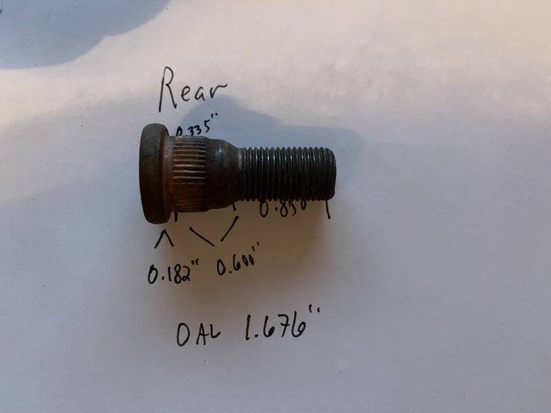

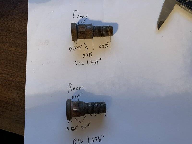

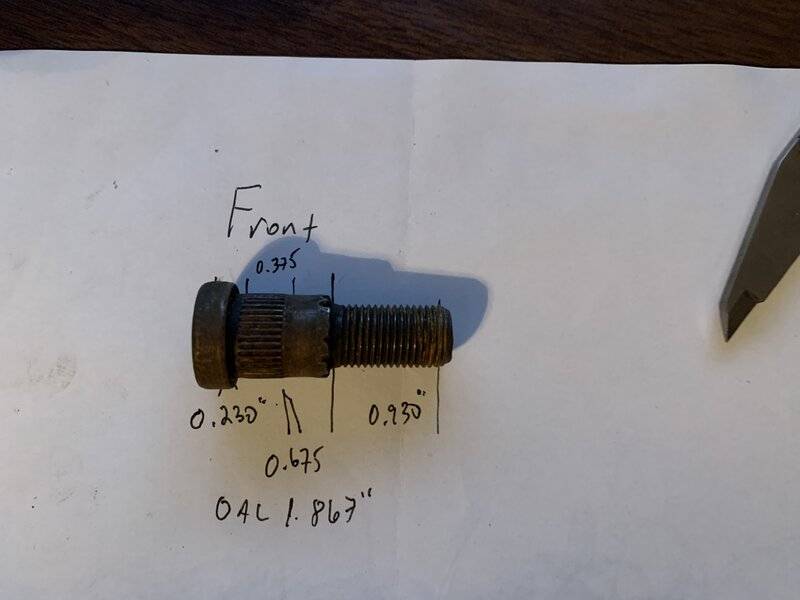

Which studs did these cars come with originally?
Front: Head 0.230", Knurl 0.375", Shoulder 0.675", Threads 0.930", OAL 1.867"
Rear: Head 0.182" Knurl 0.335", Shoulder 0.600", Threads 0.850", OAL 1.676"
View attachment 1144674 View attachment 1144675 View attachment 1144676
Thanks! Does Dorman have the correct ones, then?
Why are the rears different? Is there that much difference between the flange on the rear axle vs. the hub in front?

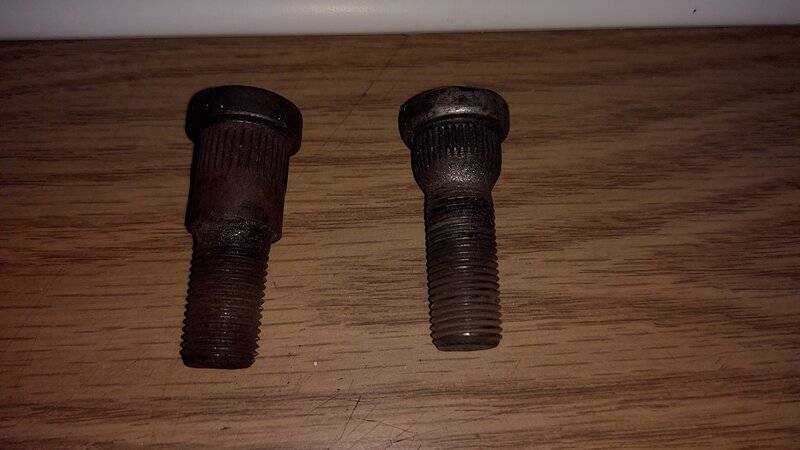

Here's a couple examples I pulled off the old hub on the front of Fred:
Yeah, at least one of those is wrong for sure....

Ah, that explains it thank you. So I guess in my pic, the one on the left is correct for front and the right
one might be for the rear?
(They were both on the front when I took it all apart, the attempt of previous owner).

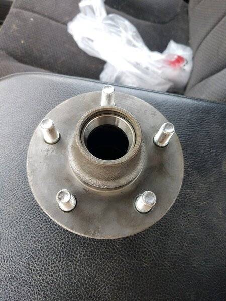

The hub arrived today, all pristine except for a little shelf rust. I know it was originally bought
just for the LH studs in it, so once those were extracted, the part went on the shelf.
That's awesome stuff, right? :thumbsup:
THANK YOU @Chi Town Runner Frank!
I verified it with a spare 11" drum and the stud holes match perfectly, too....

I took these old studs in the pic above and tried to get them to "start" in the hub lug holes - and
both studs seem a bit too big around??
They ought to at least shoulder up square before a press is needed, shouldn't they?
The shoulder would be swedged, so it will pooch out a smidge. Clean the swedge areas with a file, or just drive them home.

The hub was clearly identified by @Chi Town Runner as coming from a '68 Road Runner.
When I did some rudimentary comparing to the old hub on my '68 GTX, all seemed well....
But as I discovered today when I took the "new" hub to the local "real" parts store, the lug holes
in it were NOT the same, hence why the old lugs didn't seem right when I tried them in it before.
The owner of the store fetched the Dormans I specified, which readily became apparent that they
were NOT going to work.
Giving me one of "those" looks, he looked the lugs up in his huge bank of old paper catalogs...
and discovered the number I had given him was actually correct.
He asked if the hub I had presented was actually the right one for the car - and me not knowing
any better said "of course it is - it matches up every which way it needs to".
Well, no, it didn't in one way - namely, the lug holes, but we didn't realize that at the time, so
off he went to fetch some studs that he knew would work.
Bearing races got pressed in, along with the studs he selected and all seemed fine:

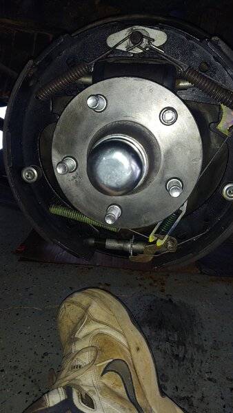

I get the thing home, pull off the old hub and all that from the GTX and go about
installing the new hub, along with new bearings, seal, all that jazz - and it all went
great...
Even the dust cap went on beautifully. Halleluyah!
....up until I went to put the wheel back on, that is.
At that point, I bumped one of the new lugs with the wheel - and it promptly popped
back out of the hub. :BangHead:

The "new" hub I had fetched from our gracious fellow member, come to find out,
was off a '68 Road Runner! He had told me that from the get-go, but for whatever
reason, I assumed it was the same as for the GTX - and it was, in all areas except
possibly the lug knurl diameter!
Dorman showed that some possible lugs for the Road Runner were actually .625,
which obviously was what the new hub had for lug holes.
Mystery solved - although how I managed to get one of my old, larger lugs from
the GTX to actually bury in one of those smaller holes remains a bit of a kick.

Thanks (and I truly believe RR was our last great president, too) but of course, now I wonder if what I have
is a hub from a Road Runner that had 11" brakes (but smaller lugs) - or did it actually have 10" brakes and
the hubs between the two are similar, except for the lug holes?
To make matters worse, there are no part numbers on these hubs anywhere....confusing.
You know where I'm going with this...
Just how many different hubs are there and how much interchangeability is there amongst them?
How much of the precision locating of drums in alignment with shoes/backing plates is done by the hub,
versus the drums' casting itself?
If all the difference there is between these is lug knurl size, that's comforting for me in my case.
I need to fetch a set of wheel studs for the front of my '68 GTX.
11" drums, all stock, running Magnum 500's (steel wheels).
I'd imagine this is pretty standard stuff across the board though, right?
Stock studs, steel wheels, drum brakes - shouldn't they be pretty much the
same?
Turns out, not so much:
when I go look at the Dorman selections though, they're all over the place
(and even differentiate between rear and front!).
The heck? Rear wheel studs are different than fronts?
https://www.dormanproducts.com/gsearch.aspx?year=1968&make=Plymouth&model=GTX&origin=YMM&parttype=Wheel%20Lug%20Stud
Keep in mind, I'm talking RH threads here (not LH), 1/2-20.
When my local "real" auto parts store told me they didn't have the "right" studs
recently, they instead handed me some others and said "these should work".
Not so much, turned out - took some honing of stud holes in the hub as well as
some serious pounding and pressing to get them in.
I won't be going that route again....
Funny thing about the measurements. They omit the most important one... the diameter of the knurled part.
