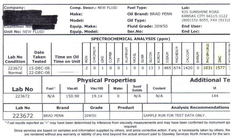

Wish I saw your post before I ordered the Brad Penn 10-30 from Summitt
What is the zinc content?
I forgot the number as I will have to look but I know its alot as thats why I stayed with it and like I said I have never wiped a lobe and all I ever run is flat tappet cams. Ron
Just received two cases of Brad Penn 10W 40. Amazon $150 delivered = $6.25 qt. Engine builder recommended. Engines I own that have flat tappet cams: Gen II Hemi

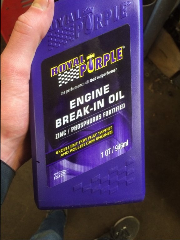

Don't mean to revive the dead here but I recently picked my car up from a shop after getting some seals replaced. The shop owner said he replaced my oil with this....
my concern is that because it is break- in oil will it cause my engine harm?
I doubt it will harm your engine - however I believe "break in" oil is only meant to be run for a short period of time. Usually would be used with breaking in a newly built motor and then changed shortly there after.
That's what I thought, I'm going to change it this weekend. Thanks for the help!
