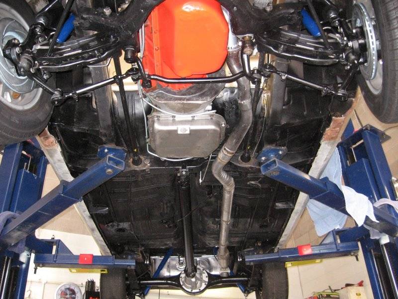

Lately I have been using Truck Bed black.This was a quickie blast. Not the best job by me on this beater.
This is the best photo of Truck Bed Black when doing this car. Done with spray cans.Just a thought.

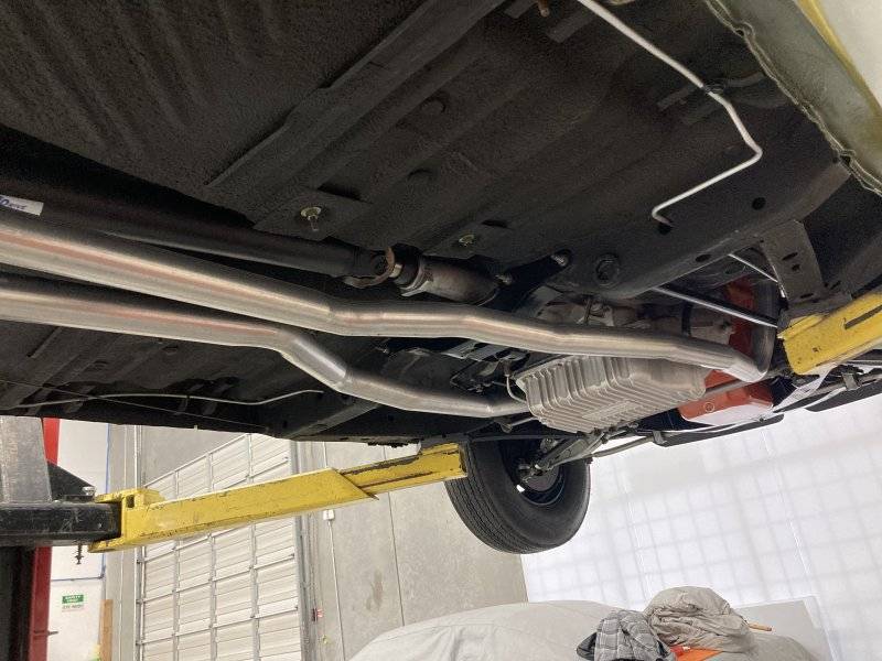

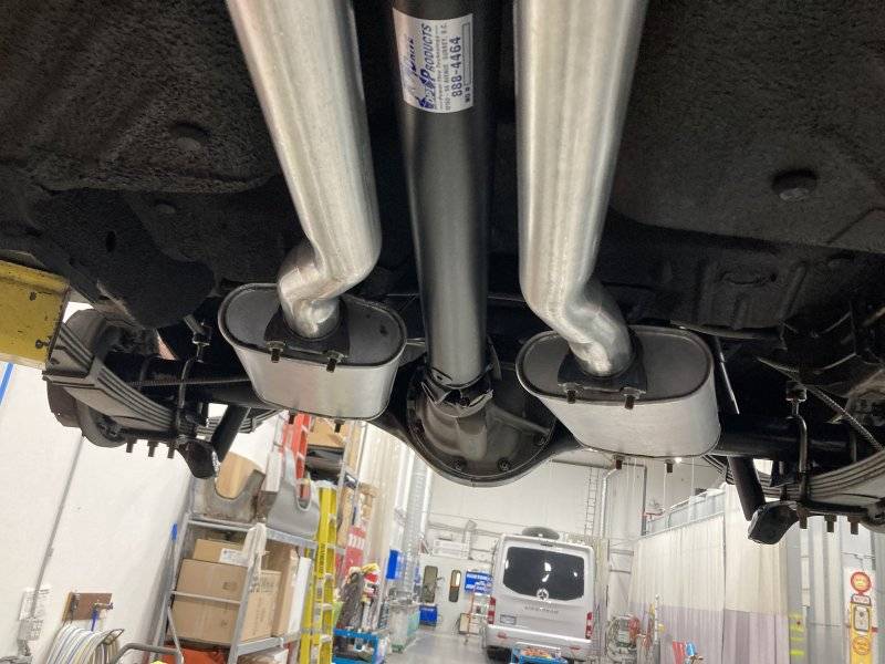

I put my Challenger on the hoist and soaked it with spray nine and pressure washed the undercoating and it came out nice
