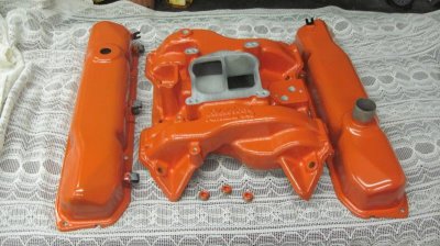

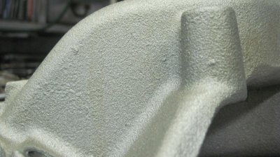

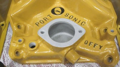

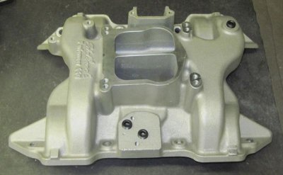

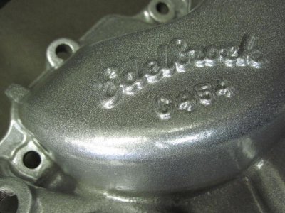

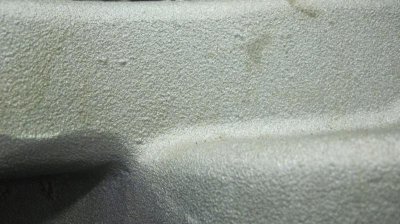

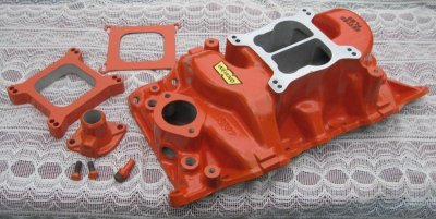

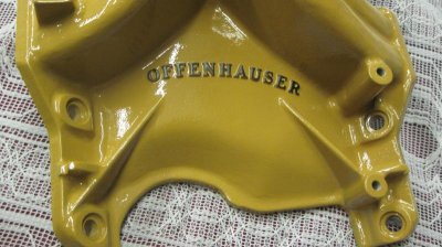

You don't want to just clear a cast iron manifold -- not only will it yellow over time you're merely going to preserve all the splotchiness and unevenness of the blasting effort. Here's a couple finishing ideas ...

Nahhhhh, that's enough snakey. I'm not a salesperson, just a motorhead. Besides, most of the intakes I coat are aluminum. :D
Thank you sleepar! And yes doll, I go through all of that on EVERYTHING. My customers come up with the parts, the amazing color schemes and customization ideas and I just turn it all into reality. It's my job ... and I LOVE IT. :D

The hemi orange intake and valve covers in the above pics are mine..Leanna did an amazing, flawless job on them. If you need anything powdercoated she is top shelf...

Yes hemi#1, it will. It'll just be a shinier version of what it looks like now after the blasting. That color will depend on whether it was glass bead, walnut shells, aluminum oxide, black slag, etc., since each has its own properties and affects the metal differently.
If you're going with a clear powder coating over a bare blasted substrate, make sure the metal is properly prepped first by an experienced coater or you'll end up with serious outgassing: little bumps and fissures all over it and a lot of discoloration under the clear due to all the chemicals (gasoline, carb cleaner, etc.) that leached into it over the years, and air -- trapped in the metal when it was formed -- all coming to the surface during the cure cycle. It might look all right from a few feet back but up close it will be hideous and bumpy to the touch.
Had to edit this to thank you for the kind words clemul!! :D I guess I was typing while you were and I missed it. If I remember right, yours had some of that discoloration I was talking about a minute ago.
Uh huhhh, I thought so ...
And all those annoying little divots and casting defects are gone too now. It was a fun job! I love playin with aluminum :D
