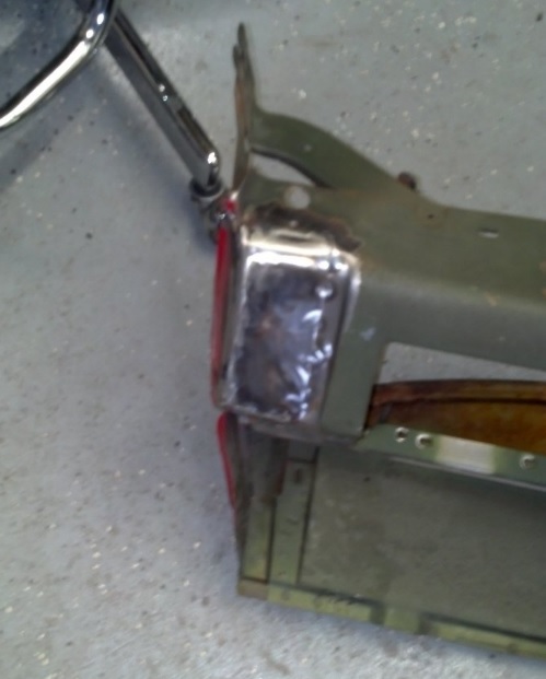

Has anyone welded off the a/c dash vents on their rally dash?

I am going to zip these hole's shut as soon as the plastic bezel's that cover the vent hole's i bought arrive in the mail. I will have to pre drill the hole's for the screw's.
After this it is off to the body shop for paint.

Problem solved. I just formed the same gauge metal to the bend, and welded them shut. It is the body shops problem now lol.
Wouldn't the non-AC faceplates just screw on over the hole and cover it up?
No the ac vents are huge and the covers do not completely cover them. There is also the upper screw that you have to have metal catch it.
