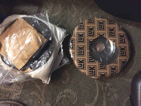

I just picked up a LUK flywheel/disc/pressure plate/tb combo. I’ll let you know once I get it installed and some time on it.
Where did you get the Luk clutch package ? I’ve can’t see to find it .

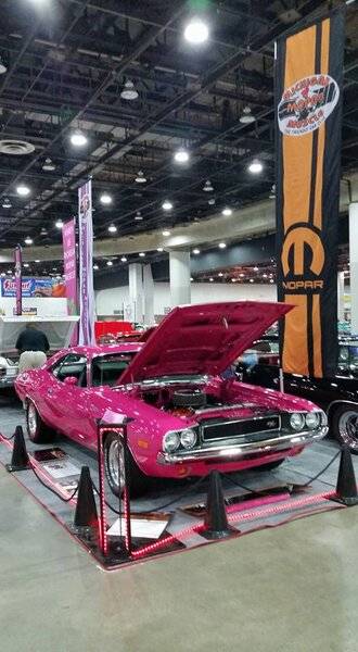

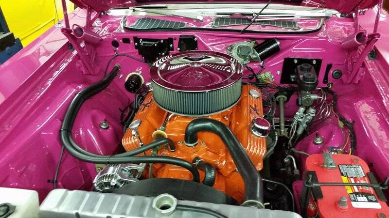

Its my wife's street Challenger. I raced it a year. It's had over 100 passes at the track on slicks. Been 12.52@110, mufflers air, cleaner, 9.1 360 on 87 octane.
Doug
