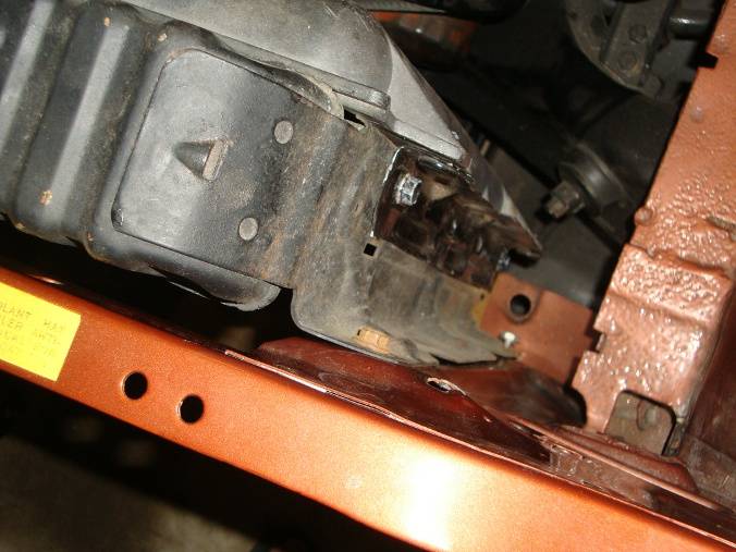

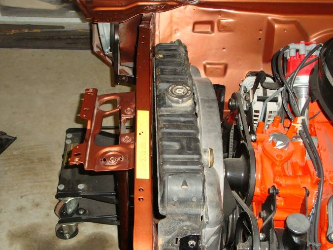

By the way...that gap at the top between the support and radiator is pretty normal when compared to the factory setup.

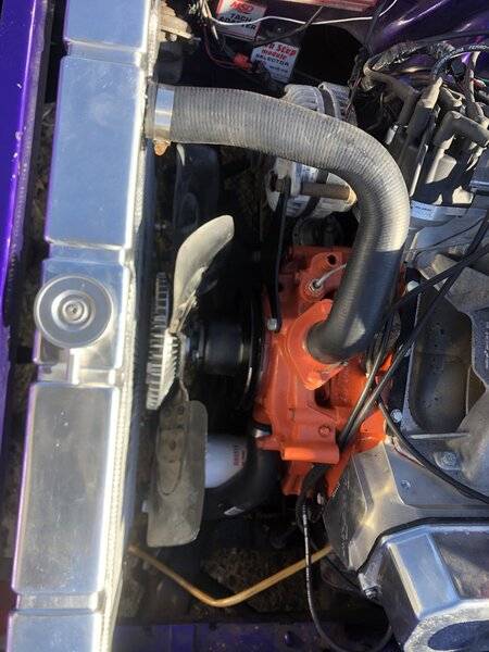

Thank you for the pictures. Your stock radiator sits much higher than the one from Cold Case did.
Oh that isn't mine, sorry...I should have noted that. Who knows if that guy even has it mounted in the proper holes lol! But the top gap is due to the mounting bolt areas of the support being raised a bit. I know that wasn't your biggest problem but since there was some discussion about it, I figured I'd post those up..

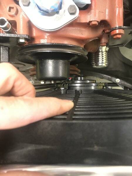

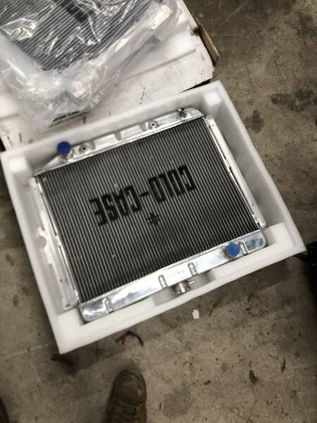

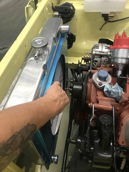

View attachment 1081644 View attachment 1081642 Just got this beautiful new radiator from cold case. I ordered an electric fan because I wanted to do away with the engine fan. Coordinated with them about which set up to use. actually through this site. Radiator is beautiful. looks great! however I go to put the fan shroud on with the electric fan and there is no way it is going to fit and not be jammed up against the water pump pulley. Am I missing something?
I have been looking at some radiator pictures of both stock & aftermarket ones. I have noticed and also give you notice that with the CC radiator you have, the filler neck sits what looks like 2-3" higher than all the stock necks I've seen. With that being said, maybe that why yours sits lower???? Just observations, your closer so you have a better advantage of seeing that. I hope CC reads this and takes notes and makes improvements?? Good Luck

I did look at that. I could not get the edges of the radiator brackets to fit through in order to do that. I tried multiple ways.

Speaking of room between the radiator and pulley, hey @BAFRAID if you don't mind what is the measurement in there from the radiator, to the face of the water pump pulley?
I apologize. I said I would get back to you with that measurement. I actually packaged up the whole thing. Sending it back. I know I have 6 inches from the face of my support to the front surface of the water pump bolt. I spoke to another radiator manufacturer. They were extremely confident and had very detailed and specific information for my application. I was able to order one of their set ups with electric fans. Once I get the whole thing here and assembled I will post pictures.

Sorry to hear about your problems as well. I ended up going with a recommendation that another member here used. I went with a wizard radiator with 4 9 inch fan cooling set up versus one large fan in the center. It also uses a bracket to hold the fans versus a shroud as they already cover 95% of the radiator. It’s only 5 inches thick in total so will leave me about an inch and a quarter of space between the fans and the pulley.
