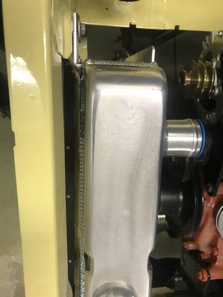

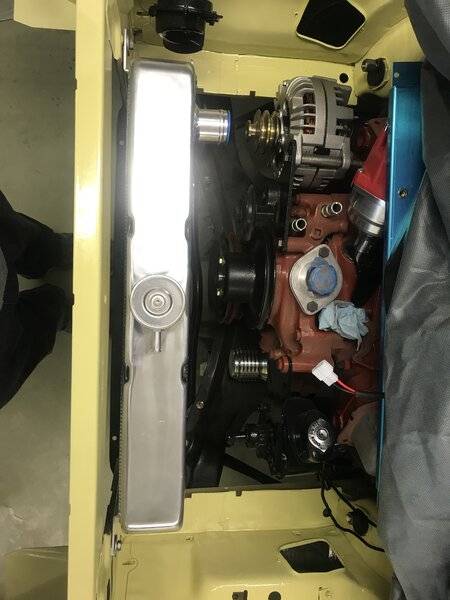

View attachment 1081644 View attachment 1081642 Just got this beautiful new radiator from cold case. I ordered an electric fan because I wanted to do away with the engine fan. Coordinated with them about which set up to use. actually through this site. Radiator is beautiful. looks great! however I go to put the fan shroud on with the electric fan and there is no way it is going to fit and not be jammed up against the water pump pulley. Am I missing something?

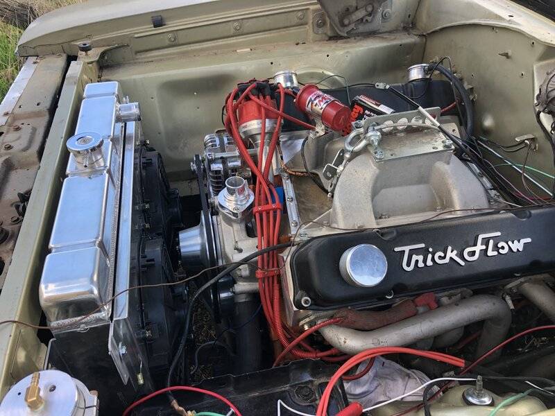

I have the same radiator, but two smaller fans from cold case and the water pump pulley
is between them with plenty of room, your radiator sit awfully low for some reason
Regarding the distance from the core support to the top tank - my radiator is original and there is half an inch between the core support metal and the edge of the top tank.
I went out and checked my GTX.
That Cold Case radiator is pretty close to right when compared to stock - based on your pic.
But the main point here is they said the fan will fit and it does not - from other comments I see no reason they will not resolve the problem.
I agree with the above post that your radiator is sitting way to low. If it was up where it is supposed to be, I wonder if your fan would then clear?
I have the same radiator, but two smaller fans from cold case and the water pump pulley View attachment 1081753 is between them with plenty of room, your radiator sit awfully low for some reason
I’ll go back and look at that when I get home. The other thing I noticed about yours and mine is on the top the grooves on yours run across the top of the radiator and on mine it’s flat. Maybe we have different radiators?
I bought the radiator only with the intention of running a clutch fan and shroud and that didn’t work out so I called Cold Case and order the dual fan set up, but it was much more expensive than buying the radiator, electric fans and shroud together, I got the impression on the phone that they just grabbed some price out of the air, it was around $300 plus shipping, maybe they will show you some mercy. I have a 69 Dart with a 512 and on that car I have the fans in front of the radiator pushing, but pushers are less efficient so you need larger CFM fans.
My radiator is 26 inches wide, it’s in a 66 Coronet 500, I forget the model number. I used the provided mounting holes but the radiator was too high and the hood hit the cap so I moved it down 1/2 inch.

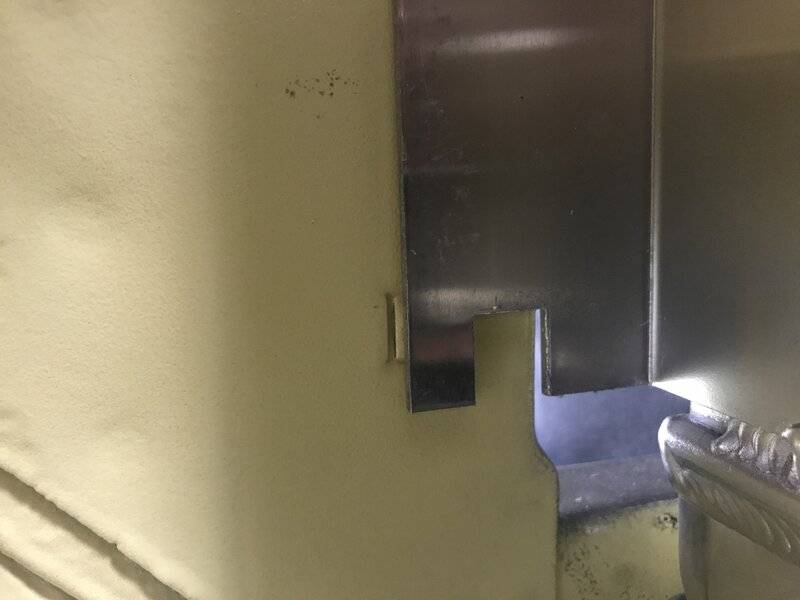

I have not seen a single CCase installer that didn't say that they had to modify one hole to fit the rad support bolt location and it has been suggested more than once for them to fix their jig... nadda..

We have plenty of B body owners that have Cold Case kits successfully installed. That being said, since your car never came with an electric fan/shroud kit, there's a number of variables that can affect the clearance. The first one is that our radiator is thicker than the original purposely to give you better cooling capacity. We could make an aluminum radiator that matches the OEM radiator of your car but then it wouldn't cool as well. So when you buy an aluminum radiator, the #1 goal is normally to have the absolute best cooling. Sometimes the trade off is clearance issues which are especially prevalent on the 22" B body radiator because a single fan is optimum for cooling but not good for clearance. We could have made a 2 fan kit that would have solved any clearance issues but the fans would be so small that they would do a terrible job of pulling air. So the trade off is optimum cooling vs optimum fitment.
