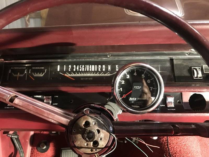

Only one I have at the moment.
I used a piece of shrink wrap on a hose clamp to mount it.

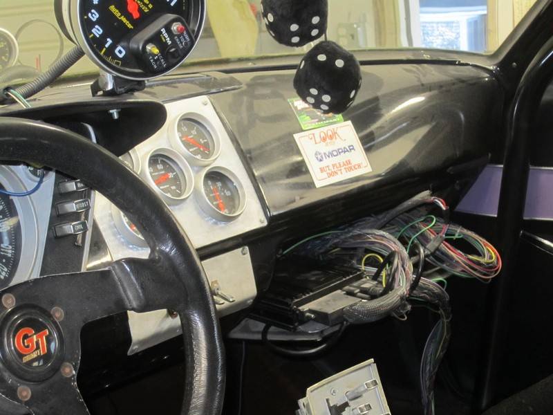

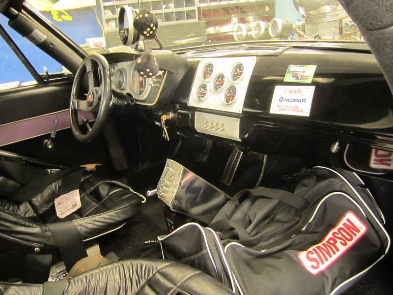

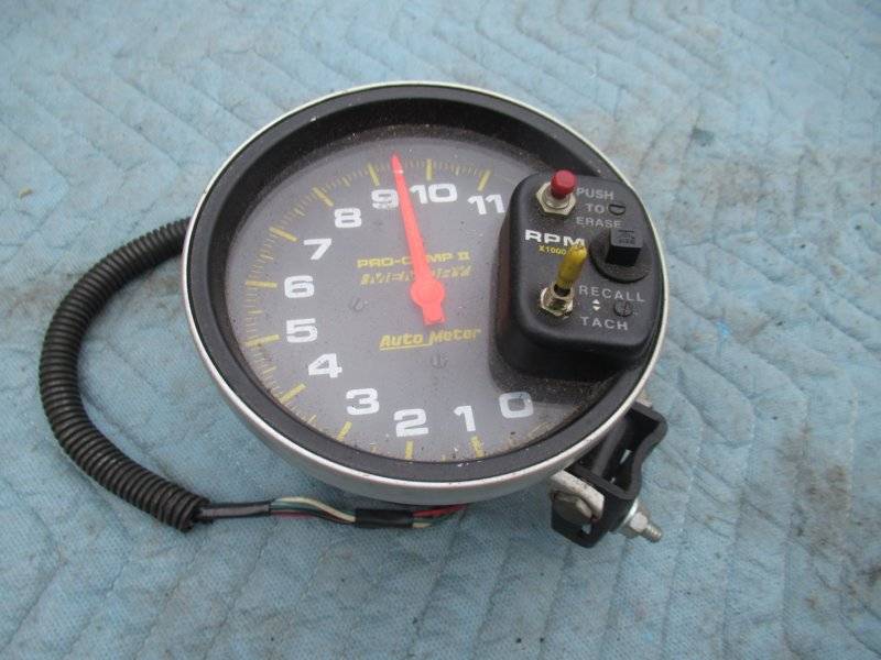

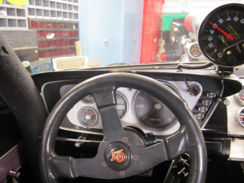

Sun Super Tach II mounted on a 4 speed column, using their hardware specifically
designed for a big-assed hose clamp (skip ahead to about 1:05):

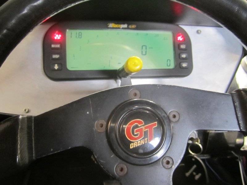

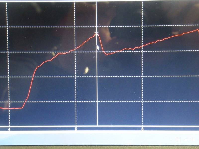

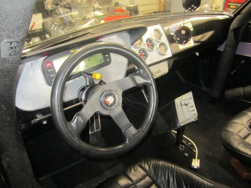

Ditched the monster tach on top of the dash for a shift light. Data log picture of RPM @ WOT in the street,,,,,minor slippage:lol::rolleyes:
3.30.18 040.jpg 7.4.12 026.jpg 8.18.13 057.jpg 8.18.13 058.jpg 9.5.15 002.jpg 9.5.15 003.jpg 9.30.187 (2).jpg
Mine is like vintage chromoly 's setup, but it came with a hole in the bracket. I screwed a very small self taper into the column in that hole for a clean install. It mounts on a rubber piece to isolate it from the metal column. Both of mine are 4 speed cars thought, so I don't have the shifter to deal with at all. I like the shrink wrap over the clamp too as I never cared for the clamp showing up on the column.
Shrink tube and big hose clamp here.
Definitely "period correct" that way!
