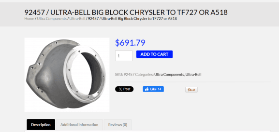

Ultra bell to convert small block bellhousing to big block:
92457 / Ultra-Bell Big Block Chrysler to TF727 or A518
No all inclusive kits that I know of.
US Car Tool sells a dropped transmission mount for the conversion, but I'm pretty sure the center part of the T-Bar support needs to be cut back and boxed in.

$700 for this?
How many Ultra Bell adapter housings do you suppose they have to sell to even justify casting/machining costs? Let alone make a profit? I applaud them for even giving us the option!

I have an A518 with the Ultra bell that hopefully someday I'll get it installed into my 72. I got lucky and bought the rebuilt tranny, new converter and new bell housing for 700.00 from a guy out in the bay area.

This. I don’t think folks realize the cost to manufacturer low volume parts. I think we’re getting pretty close to the point where some stuff will no longer be made when current inventory is gone.
Indy wants $1040 for the 440 2D aluminum intake. The market for that intake is pretty low.

So, what is involved machining wise to make that kit conversion?
Job for a mill I would imagine. The unit locates off of the front pump bolts. You may be able to saw off the bulk of it, then finish in the mill. As I remember, the unit is an SFI spec shield too. I believe the company was based in Florida the last time I looked.
Pretty common in the power glide world.
Cut it off any way you like. How you install is what matters.
