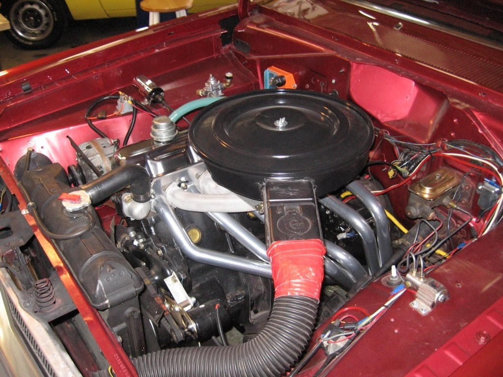

I'm looking for input on an idea for fresh air to feed my 65 Belvedere. My thought is to use a Spectra dual inlet setup and feed it through the inner fenders near the front. I would fabricate a baffle to keep rain water out. I want a stock hood.
Opinions?
Mike
One of the best performance upgrade you can make for very little money.I picked up 4 tenths with this setup on a drag only 12 second slant six Dart.$10 worth of junkyard parts.Ran the tube thru the rad support to the grille.Not very pretty but works.
