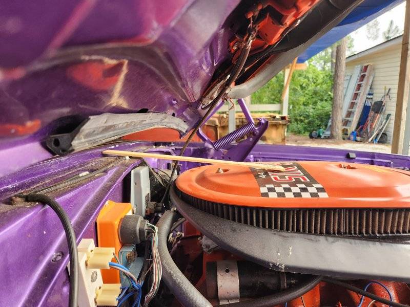

I would like to know if my air cleaner will clear my new AMD GTX/Roadrunner fresh air hood. I am not able to test fit the hood right now as I am working alone and don’t have anyone that could lend me a hand.
I was wondering how my drop base air cleaner sits as compared to your air cleaner in your fresh air set up. If mine is equal or lower it would indicate I am probably ok.
Mine appears to sit just above the inner/lower hood line. Maybe an inch?
Her is what mine looks like. Too high? . Can anyone take a picture like mine and post here for me to qualitatively compare?
Greatly appreciated guys!
MF

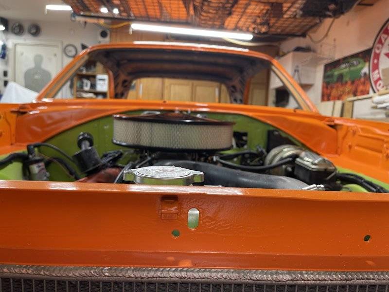

70 Bee with RamCharger hood dont know if this help.
Thanks Dave very cool car and set up! Love it!! It seems for that assembly the air cleaner sits at about the lower lip level in the back and towards the front its a bit higher but seems still at the lower lip level or below. It’s a different design but worth seeing. Will be interesting to see how that compares to a GTX OR Roadrunner!
Thanks so much for taking the time to snap those off! Great car!!

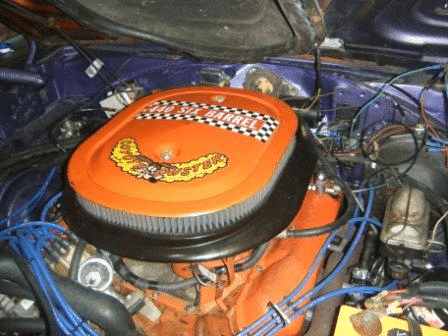

1970 roadrunner pic
does look taller
I dunno....that "looks" 2"-3" too tall. The 70 air grabber hoods are REALLY tight
1. 340 helps (shorter)
2. Aftermarket intake hurts a lot (taller)
3. Holley hurts (taller)
I will throw a few ideas out there because I see you don't have the hood on the car.
a. If you're just trying to drive it, maybe don't install the fiberglass box underneath the hood?
b. The bottom of the trap door (passenger corner) dips down surprisingly low into the engine compartment
c. A GTX 440 air grabber will help (1" shorter than the 340/383 air cleaner) assuming you want your airgrabber hood to work.
d. I think you'll need one of those Edelbrock "triangle low-profile with foam filter" air cleaners, even with the drop base, if you want to use that carb/intake.

To me it looks like the Dodge sits low and plymouth sits higher. I did have a 750 Holley DP on my Bee when I bought it and it fit no problem under the hood. .I think the manifold is biting you. Did you compare height on old intake with the new intake?
Hi Dave it is! I am talking with the guys over ay Abodies and one was nice enough to furnish me with this gem of a picture. Seems like the manifold is at least an inch higher? What do you think?
1970 RR ,to me it looks even or low. I think you will be to high.

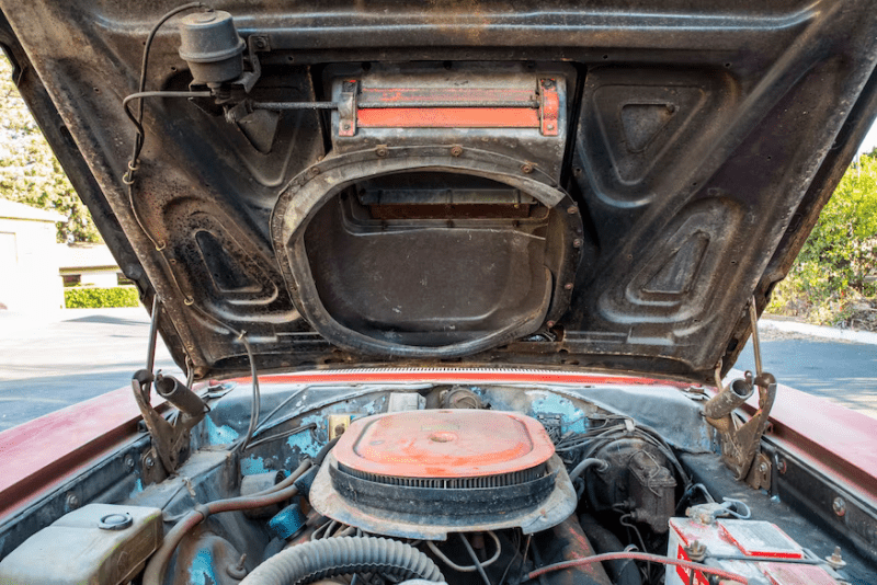

B. Now that I think of it, the corner of trap door hits the big oval air cleaner (all 69 air cleaners and the 70 six pack air cleaner) The round top 70-71 4bbl air cleaner should clear the trap door since it's smaller
C. For 70-71, the 383/340 air grabber air cleaner base is 1" taller than a 440 air grabber air cleaner base
D. Edelbrock triangle air cleaner - Yes, one "cough" and that foam burns up. I used to carry a spare filter element
In general, if you have the hood on the car, couldn't you lower it down VERY slowly and see if/where it hits? Maybe take of the hood latch so you can lay the hood down all the way without the last little "shove" to latch it?

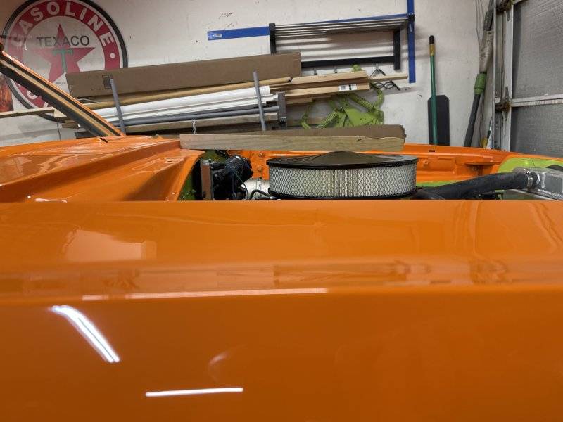

Ok battling the 117F heat here. My garage is a tad warm lol. I was able to pull off the carburetor spacer and it made a significant difference as see here. I am now feeling more positive about this. The one thing that I may still have to do is buy another intake manifold. This would be for 3 reasons.
1. Will gain 3/4” more clearance. The Eddy Performer 2176 is shorter. This is the least rational reason but 3/4 now is a big deal as I am closer to where I need to be.
2. There is proper street vacuum access without having to cut into a nice race manifold. Again not a super major contributing factor.
3. Its a better carb for the street. Should not sacrifice lower end performance where I’ll need most often. This is the main reason.
