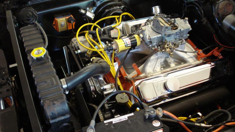

Alright, after removing the leaky bolt, drying everthing and then applying sealant I've realized that the bolt is stripped! So, now I have to try to tap some new threads without removing the head.(yeah, like that's gonna happen)
Anyway, thanks for the replies and attached is a photo of the new engine.
