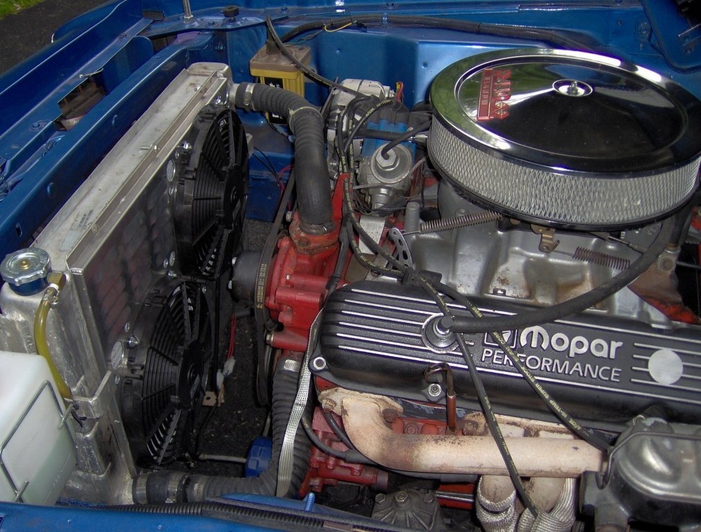

Thanks again to all for the responses. Hemi-I,Yes in fact it does get hot over 40 mph. If it is cool outside maybe around 50 degrees it does much better and will run around 185. Even at Idle it will slowly build up to 190 to 195 with both fans on.

Howdy there Bigman, I pummeled you with cooling questions during your Evans conversion and you were very helpful and thorough I and appreciated that. Your new input and link to the Ron Francis cut out sounds good. I have installed manual (run) switches for each fan already; along with run lights that tell me power is to the fans. I have done this on every electric fan on every car I have owned. Never trusted relays and sensors to be 100% reliable. I never heard of a system cut out for the fans though. But, that opens up a whole new area to discuss.
First, I wonder how many CFMs the factory mechanical fans were rated at for a high optioned A/C car. Then there are the discussions on how deep to install the fan into the shroud; which brings up my next quandary. Many aftermarket fans can be purchased separately and pre-installed into a shroud. The design of the shroud and how the maker installs them is my next can of worms. I have noted that some shrouds have either holes, holes with flaps, or louvers or are solid,(just the holes for the fan or fans themselves). I will try to attach a photo of my past 22" Northern radiator with its factory fans and flow through louvers.
As you can see, not only did they provide flow through cooling, but I even added some more with a hole saw to augment theirs. Of course, after I did it and saw some other shroud / fan setups that used rubber flaps that I believe open during driving and thought that maybe the ones I added decreased the efficiency of the fans at stop / idle and low speed. I put those same 1100 CFM fans on the new 26" radiator shroud from ECP. Funny thing is, there are no other holes in the new shroud so it kind of makes sense that they could in fact impede air flow at highway speed. As $$ is always tight, I will first try a cut out switch for my fan controller and see if that helps. By the way, I installed a Derale dual fan controller that I can adjust to an extent. The only thing I can set is Kick on temperature which I set approx. 175. The second fan will kick in 15 degrees later. With my override switches I switch the second fan on myself when I approach a long steep hill to kind of head it off at the pass. Remember that my car was stripped so I can't switch on a heater/fan to assist with cooling when approaching high temps. My water pump is a 16 blade high flow (Flowkooler) and it did not help much after installing, even with the high flow stat. I will post a picture of the new fan-shroud setup later, (when I get home). The flow through the radiator looks good after the stat opens. I am also going to install a plastic, viewable strainer insert into the upper radiator hose, that I just bought.
That way I can see the flow when it's all the way up to temperature and the cap is on! By the way, I forgot, Bigman, my radiator is 2 rows of 1" tubes. If it winds up that I need more cooling capacity, I will go for a 3 row of 1 1/4" and 2 variable speed 3000 CFM fans, that is after I sell a few internal organs on Ebay ! I see that you have about 800 more cfm's than mine are. Also I will most likely change out my dual Trans-Oil cooler for the Heat-sink can type. They are cheap, about $25 a piece; but it breaks my heart to have to do that after I was so proud of my installation with it's AN fittings and all. Makes me wonder what can I expect if I ever install an A/C system with that big condenser blocking the airflow! By the way, I rarely hit 65 mph with that 3.91 posi back there, I can almost watch the fuel gauge drop as it is! I will also do that testing with my

You have eliminated a lot of the possibilities to the overheating issue, I.E. stat, pump, etc. by the your picture I couldn't imagine those hoses collapsing? it would be the bottom feed hose that would get sucked in on itself, don't laugh it happens a main reason why I put a stainless steel spring in my lower hose! and run evans after the hose collapse in a hard hammer down run and the pressure build up of the water coolant I blew out a freeze plug and dropped it all on the road temps went to 250 in seconds, never again with the evans in there and the spring for extra insurance.
