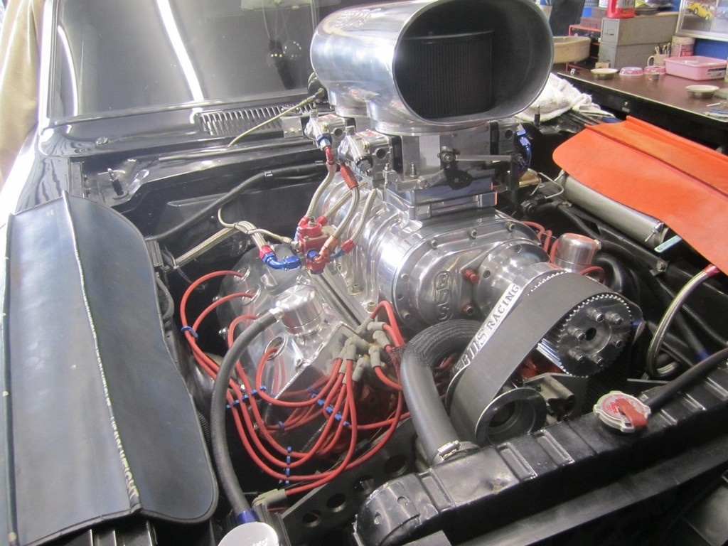

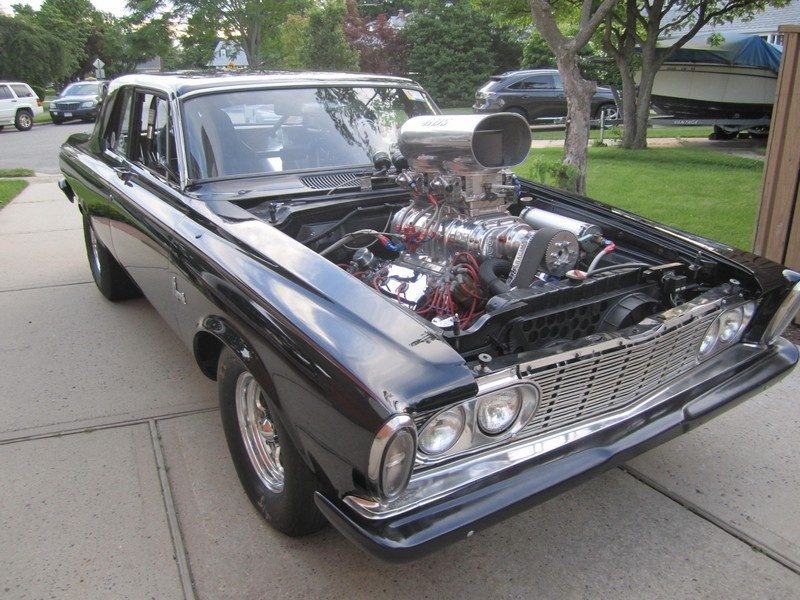

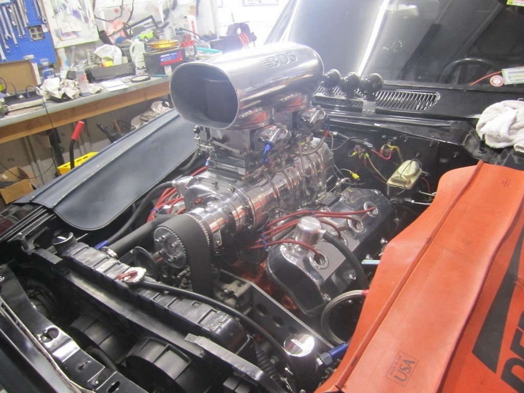

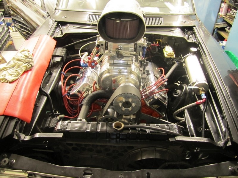

Wow, that Behemoth is awesome. Is it street legal? :D Thanks for posting. I would cut mine too if I thought it would help and may wind up doing so. I think they are afraid to put a track out there because you would just blow the doors off everyone else. By the time I finally get my wish of a Hemi and a Harley I will probably have such a bad back or hemorrhoids, that I wouldn't be able to sit on it or in it! I think it's time for this old man to hit the sack! The saga continues....Tune in tomorrow, same bat time. same bat station! Thanks again to every one.
