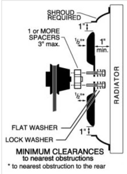

Bob at Glen-Ray radiators told me that a clutch fan should only make about 1.5 -2 turns coasting when you spin it by hand. Also He says your fan should not be more than 1/2" - 3/4" away from the radiator. Maybe you need a longer shaft clutch fan to get it where it needs to be.
I disagree with Bob...the fan should be sitting 1/2"-1" inside the shroud, not that close to the radiator core INSIDE the shroud. If you did this all you are doing is spinning air inside the shroud and not pulling any air through the radiator.

A fan can be 6" back from a radiator core, as long as it is approximately half in n half out of the shroud. It will pull air through the shroud and core the same. Here are some generic specs.

A fan can be 6" back from a radiator core, as long as it is approximately half in n half out of the shroud. It will pull air through the shroud and core the same. Here are some generic specs. View attachment 1127607

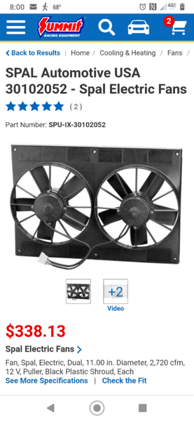

can you post a link for the dual electric puller fan / shroud setup you ordered?

I had the same problem, I was running a clutch fan with a shroud and it would slowly climb in stop and go traffic. Knowing all else was good I switched over to dual electric fans (pullers).. no more problems. I'd at least play with it until the motor is fully broke in to see if it cools down a bit.
Pushers are not a good option, even on electric fans you need a good shroud.. with a pusher they typically don't have shrouds because they would block airflow while cruising. The ones I bought came in a shroud and have rubber flaps that allow more air to pass through while cruising.
It took a bit of work to squeeze it in there but it works great, 69 Chargers have almost no room in there. I asked around on here and it seemed like around 3,000 cfm was the general consensus, it works.
Is that puller fan setup a substitute for your belt driven fan or in addition to the belt driven fan?
Is the puller fan setup installed between the rad and front grille or between rad and water pump like the normal belt driven fan?
It replaced the belt driven fan and is mounted between the radiator and water pump. The reason I went with dual fans instead of a single fan is because of the water pump, a single fan won't fit in my car because the fan motor would hit the water pump.
