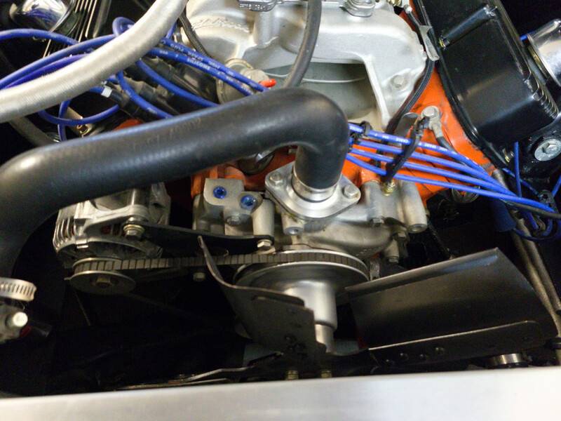

Yes, it was a bad rad cap. I ordered a Moroso expansion tank and thinking about adding a coolant recovery tank. I found this on Amazon. What do you think ???
If you leave the coolant 1" below the base of the fill neck, you don't need expansion or recovery tank. I run 610hp 496" engine in 125 degree weather with no boil over, Ever. At idle w a/c on for over 10 minutes after long drive and engine will get 222° and no boil over/puking.
