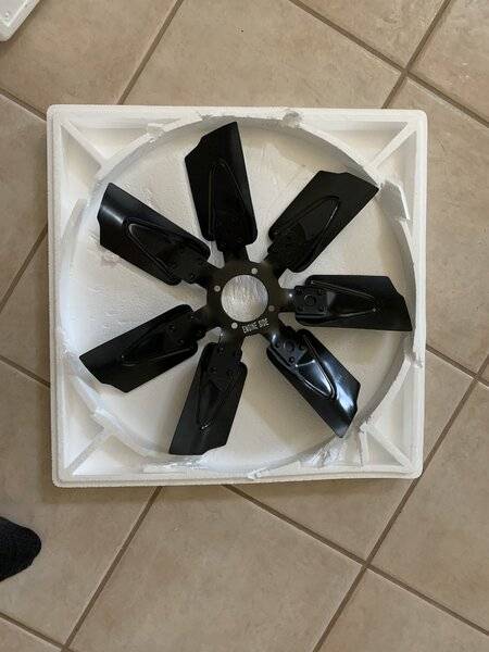

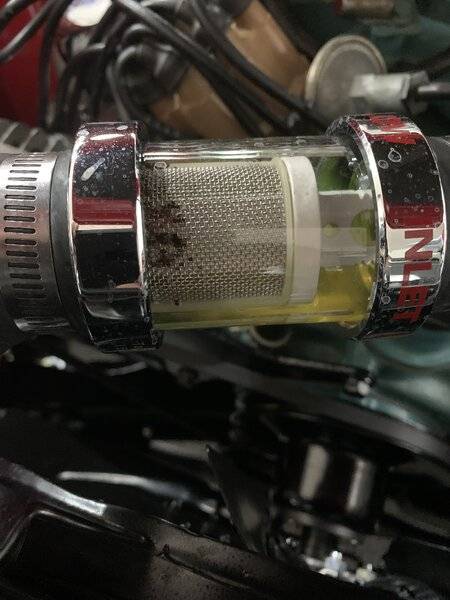

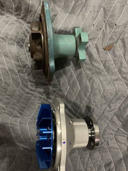

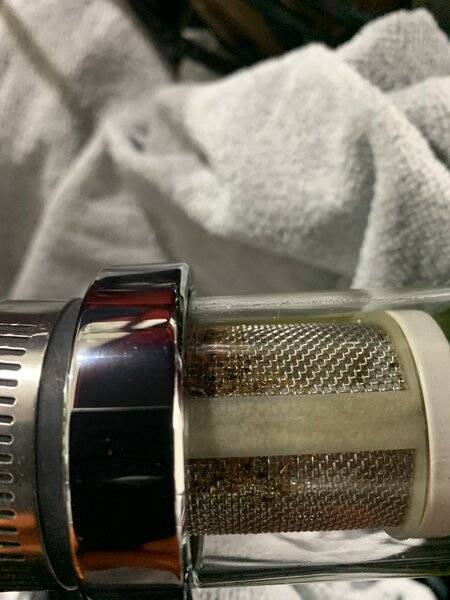

So I started with flushing, reverse flushing and did it again for good measure. The car was in a private collection and wasn’t driven much. I swapped the non-correct 4 blade fan that came on the car for a 7 blade fan w/clutch from Mancini, sent my radiator to Bob at Glen-Rey for the ultra cool treatment, Flow Kooler water pump, and threw in an in-line cooling filter for good measure! My only reservation is the clutch seems to really slow the fan down but so far no issue with keeping the temps down.
As you can see, the filter has been catching all types of debris as you can see in the pics. I have some water wetter in reserve just in case.

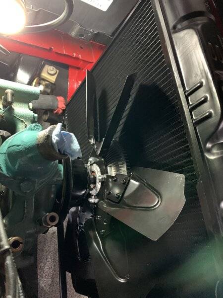

Looks like a Great set-up from here ! The only thing I would add is a shroud for it. Bob S may be able to help you with that if you can't find one local to you...
It might just be the pic but the fan looks way too close for comfort to the radiator.
Was thinking the same as Kilrbee. You want at least 3/4" between the front of the clutch housing and the radiator. Especially if you are running stock rubber motor mounts and not solids.
That’s what I love about this site, y’all don’t miss anything and are so knowledgeable which is very much appreciated by a novice such as myself.
I went back and forth, clutch vs no clutch but I really wanted to try it with the clutch so it’s a little closer then I would prefer. It’s 3/4” from the radiator w/clutch and we’ll see how she does in the summer heat/humidity. If she runs warm, I’ll pull the clutch and use a spacer to get me to the preferred 1” mark.
Fingers crossed, we’ve had some warm days already and she’s been good even sitting in traffic but time will tell!
