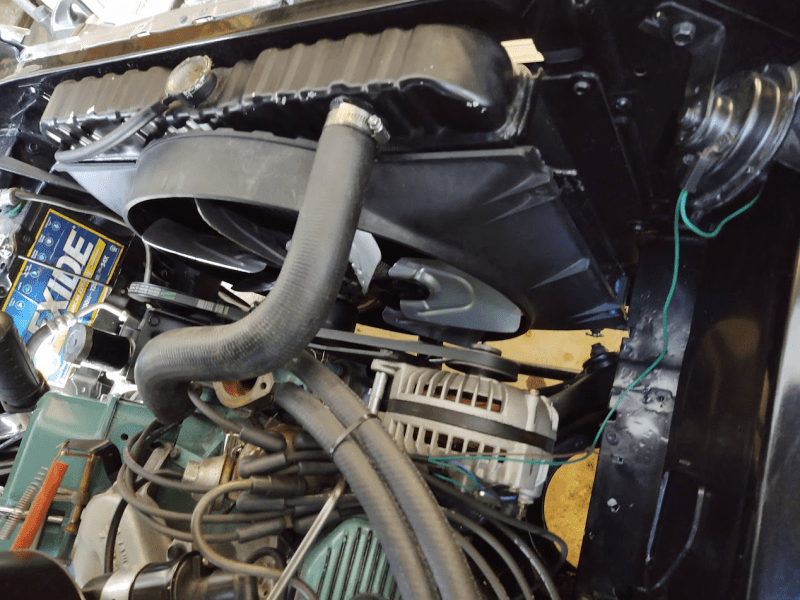

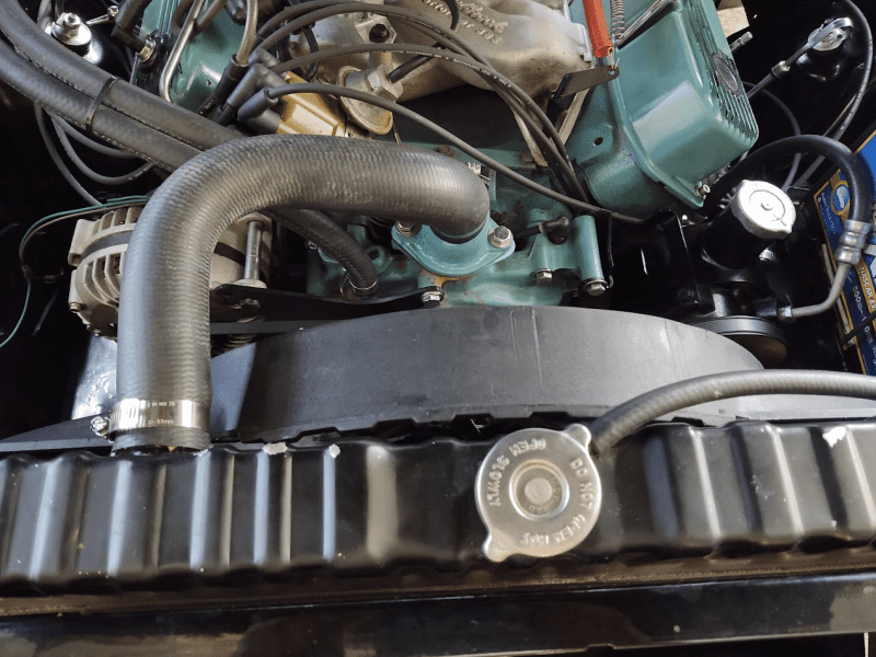

My 66 with a 383 has a 26" radiator?
I've been getting a lot of rust out from the block so I pulled the radiator and hosed it out from the outlet along with the block.
When I re-installed it I left the thermostat out on purpose to keep flushing out the rust and it ran at probably around 140 degrees.
I do have a clutch fan and a shroud on it. It's just a cheap E-bay aluminum radiator and the factory shroud fits perfect.
