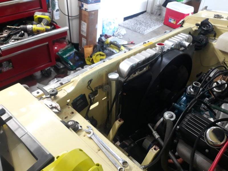

Working on cooling system upgrade today.
Upgrading to an aftermkt alum 26inch plus adding a shroud and it ain't a drop in for sure.
Need to alter the aftermkt sway bar mount brackets and relocated the overflow from pass side to drivers side took some work.
what shroud is that? I like it since it's deeper than a stock shroud (at least the one's for the 68-70 B bodies).

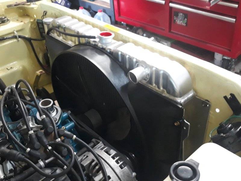

Update.
After several recommendations.
I went with one of these.
1966-1972 Mopar B & E Body Aluminum 26" Radiator Road Runner Challenger Cuda | eBay
Also added an nos 2998326 fan shroud and it bolted right up.
It has a 180 hiflow mr gasket thermostat in it now as well.
Fan is an aftermkt but pretty close to stock dimensions and construction.
Direct drive no clutch. Box stock pulley arrangement.
And so far....after a long idle time in the garage. And then a 5 mile test drive it doesnt get any hotter than the stat.
My only issue was the drain petcock cant be used as it hits the pass side strut rod. So i put a 1/4" npt plug in and called it good.
Trans cooler lines in the lower tank are also 1/4" npt to 5/16" flare fittings . So it runs the stock internal trans cooler with no issues.
The aftermkt overflow tank had to be relocated from pass side to drivers side. Due to the horns were in the way.
But it tucks in ahead of the battery tray like it was made for it.
Fingers crossed it took care of it.
