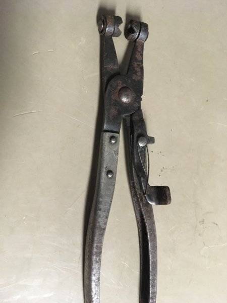

I have an ancient Snap-on corbin clamp tool. No rotating heads but does the job. Straight on or from the side will take care of 90% of all Mopar needs.
You gotta a old pair of pliers that you don't care about? Take a grinder and cut a groove in them to hold the clamp. Good Luck
K-D A29, older than than the hills!
