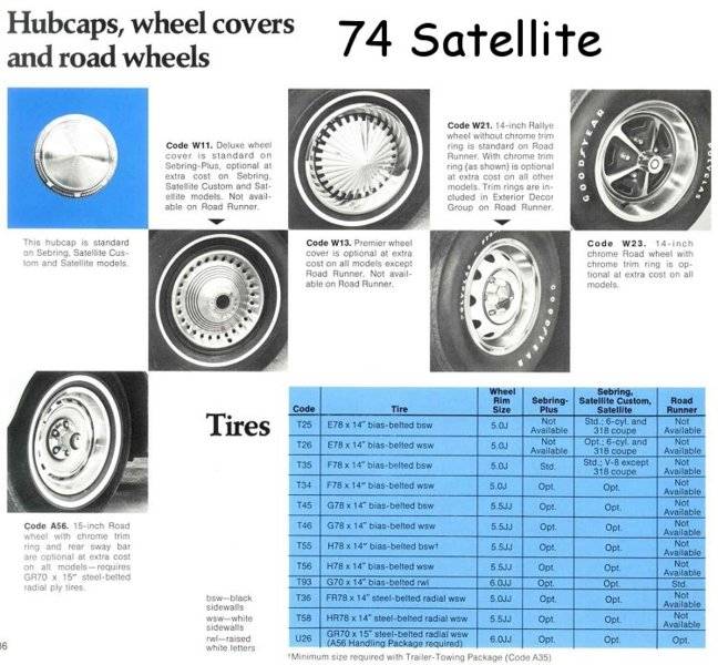

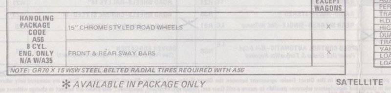

From the 74 sales brochure.
Chrome-styled road wheels
The 15" style shown available in handling package only. GR70x15 steel belted radial ply WSW tires are required.

Here's a page from the 1974 Plymouth data book. It may help.

Included with A56 option in 74. (From the back of an order sheet)
