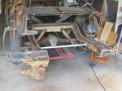

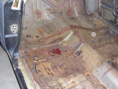

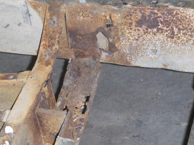

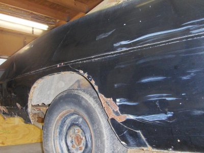

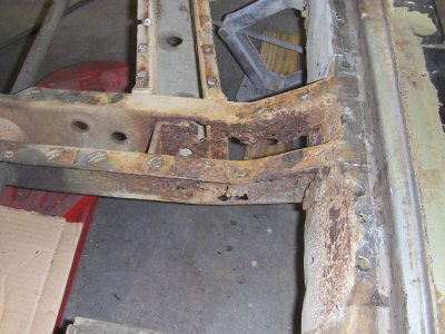

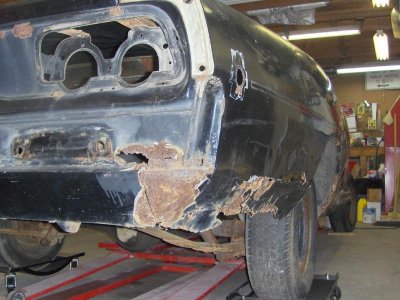

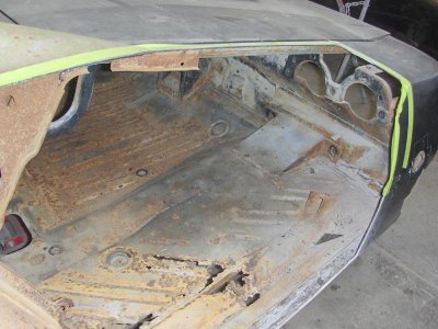

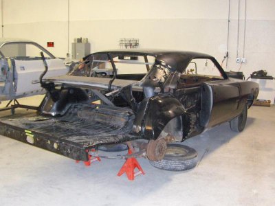

There are so many ways I could respond, but maybe pictures are better.
I'm doing a father-son car for a guy who did not realize how much his car needed when he bought it. Luckily, he can afford the parts and have me do this work. Picture 146.jpgPicture 149.jpgPicture 150.jpgPicture 151.jpgPicture 334.jpgLook similar?

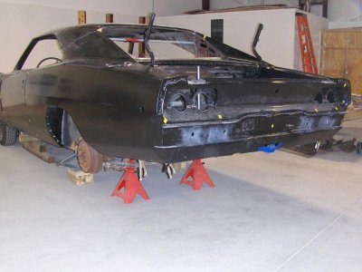

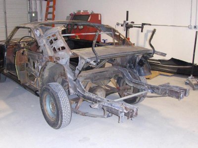

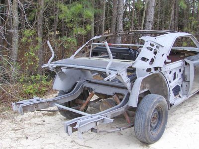

last ones

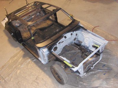

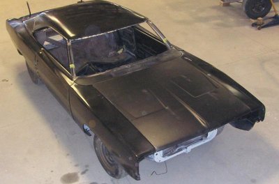

I realize you're not taking your roof off, but a lot of what you see cut away on this Charger is what you will need to do on yours. And btw, after seeing your pictures, your hinge pillar is shot, and so is the torsion bar cross member.
HPIM8800.jpgHPIM8747.jpg1968 Charger rebody 1.jpgHPIM8725.jpgOverhead1.jpgoverhead2.jpg
