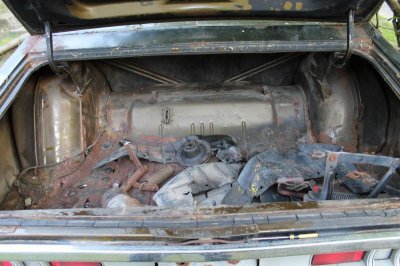

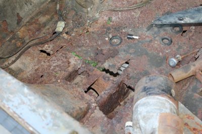

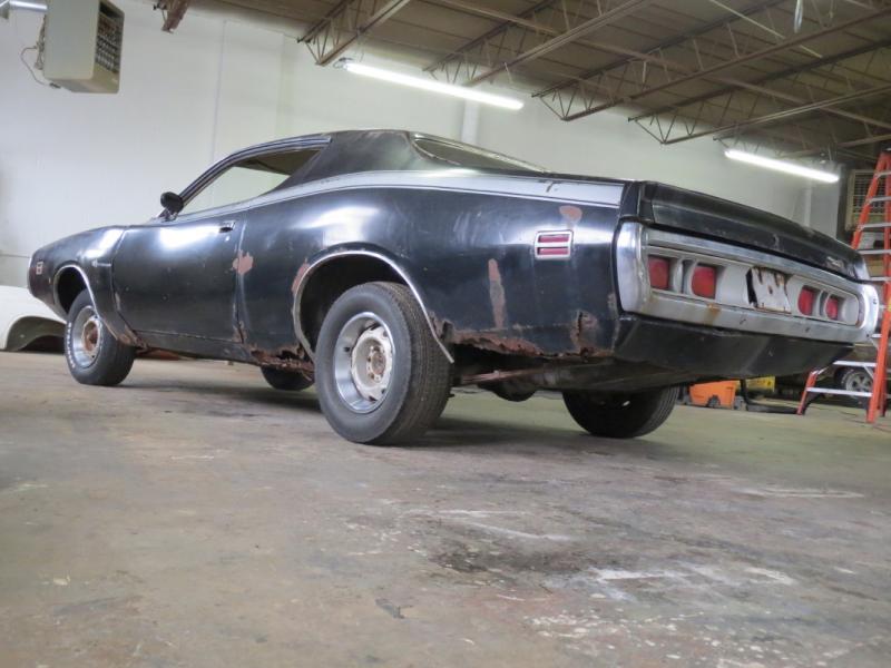

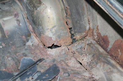

I haven't posted anything but my car. Anyway, here's what I'm looking at.
http://www.forbbodiesonly.com/moparforum/attachment.php?attachmentid=123433&stc=1&d=1371952231
http://www.forbbodiesonly.com/moparforum/attachment.php?attachmentid=123435&stc=1&d=1371952240
http://www.forbbodiesonly.com/moparforum/attachment.php?attachmentid=123437&stc=1&d=1371952291
http://www.forbbodiesonly.com/moparforum/attachment.php?attachmentid=84765&stc=1&d=1349524313
pictures from the guy I bought it off of

That's some serious rot to the frame
Yep.... my guess is rotisserie is what your going to need
I'm assuming that once I get the pans in I can take the frames out from under the car and work on them.
The frames don't just come out....you will be drilling hundreds of spot welds to get them off and then you will need to make sure you brace the rest of the car while you remove those parts. lay under that puppy and take some time to study the assembly to get a better picture of your work load. I am guessing you have at least 150% of the rust I had which took me 2 years to this point to get under control.
If I had that car , I'd get turn it into a pro street car. Make my own floor pans and get fiber glass panels. Get some square tubing and build a frame under it. Then spend all that dough on go fast parts. But that's me.

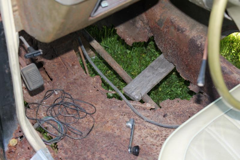

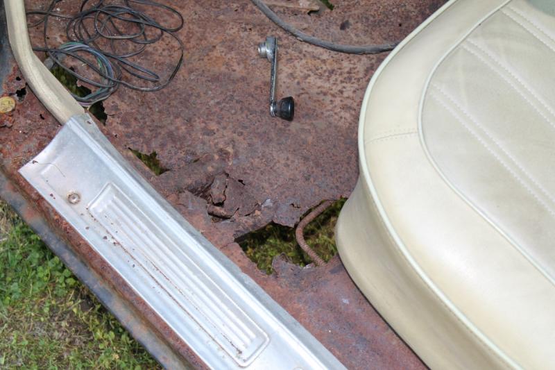

Here are some pictures of the driver's side floor pan...
Even with the big hole, the floor support seems to be solid as a rock. I've sat in the car a number of times and I don't feel any give in the floor.
Anything I should know about cutting out the floor pan? Bracing, what to avoid, etc...
Those rust holes are their for a reason! If you decide to rent the car out to Fred Flinstone he will know where to put his feet.
Well, since yall convinced me that this car is basically beyond saving; I'm just gonna stow it away for now till I can find a Super Bee shell that's in good shape and just pull parts from this car.
