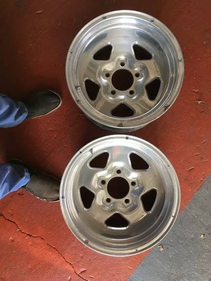

Sorry my friend....those wheels ARE NOT CRAGAR SUPER TRICKS.
They are the FENTON R/T on piece cast aluminum wheels with 15 bolts inserted thru 15 holes in the one piece cast aluminum wheel.
They were manufactured to be a streetable version of the Cragar Super Tricks.
I am sure of this because I worked for FENTON at the time. We made a 15x4 (not 15x3.5) to handle a little bigger tire for street use.
NOTE: Scroll up 6 postings to see the picture of the ad that was on Craigs List and reported to be Cragar Super Tricks (but the are not)

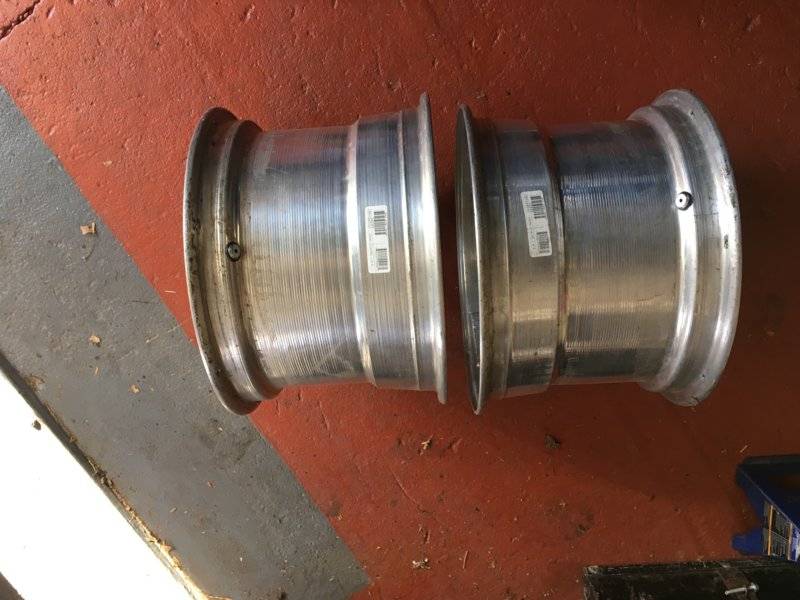

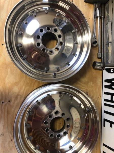

I picked up the polished fronts I was looking for at Carlisle a couple of weeks ago. Next day wet sanded (down to 1500) and buffed them out to come up with the look in the second pic. I took them apart to do this. My wheels have the generic bolts. I have a pair of rears that have stainless, allen-headed cap screws. They look great, but I doubt I'll run them. For the bolts, mine were rusty too. I bead blasted them, then cleared them. Seem to look ok.
I will be running Moroso 7.10 15 drag tires on the 3.5" Super tricks above. Looking for inner tubes for them. Anyone know what i need? Struggling to find them. Tom
Coker Tire has the tubes you need if you want to use tubes. I'm trying tubeless. A little more silicone on the gap.

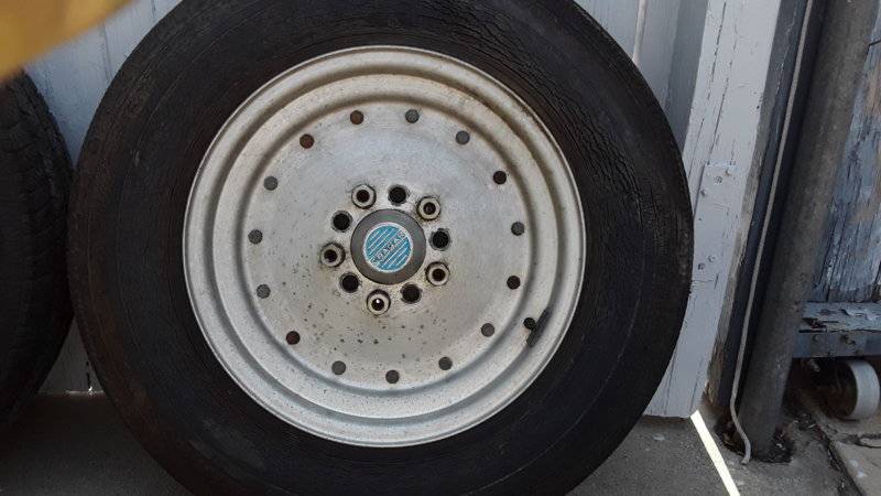

I'm late to the party but this is my favorite look. Mine are Centerline Draglites that as far as I know are kaput. 294 rear, 235 front. Any tips for cleaning/brightening the old satin? Heard it can be ruined so I leave em alone mostly.

I run my front runners tubeless. I had them apart, cleaned, reassembled and a nice coat of permatex silicone all the way around. No problems at all.

View attachment 836043 I'm late to the party but this is my favorite look. Mine are Centerline Draglites that as far as I know are kaput. 294 rear, 235 front. Any tips for cleaning/brightening the old satin? Heard it can be ruined so I leave em alone mostly.
I use Spray 9 cleaner to keep my Super Tricks clean. They are not meant to be shiny and if you polish them they will look like crap.
Aluminum brightners will work but they will leave the wheel white looking.
Thank you for the replies. I had the wheels apart to clean and polish. They were already sealed. When I mounted the tires without tubes, they leak down to nothing in a matter of hours. I may pull them back apart this winter and go all the way to 2000 grit to make them really shine. When I do that, I'll re-seal them. Much appreciated the responses.

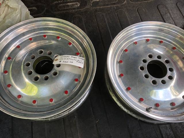

Just got a set of Cragar Super Tricks :D
(15x3.5)
Both are the same but one is drilled for dual bolt patterns and the other is only for a 5x4.5 BBP
Same 125/70r/15 Tires on both
