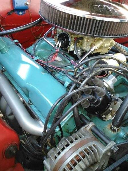

now that I have my new carb & E choke...boom! starts right up...even in frigid temp...love it..
used to have to crank & pump the living **** out of it
